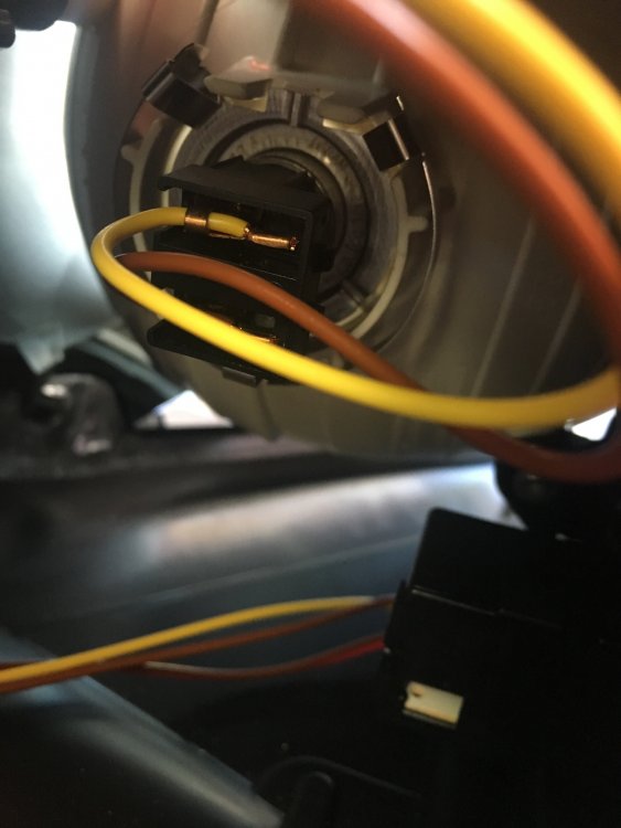

I hope this picture helps,I also struggled to change my side bulb as the manual stated it needs to turn.
As you can see there are two clips holding it in place. This is a difficult procedure if you have hands like shovels  like myself.

Thank you for above picture. Just realised I've been putting bulb in upside down trying to insert with the single tab at the bottom! Doh!
No worries it wasn’t the easiest thing to do as you can’t see what you are doing
