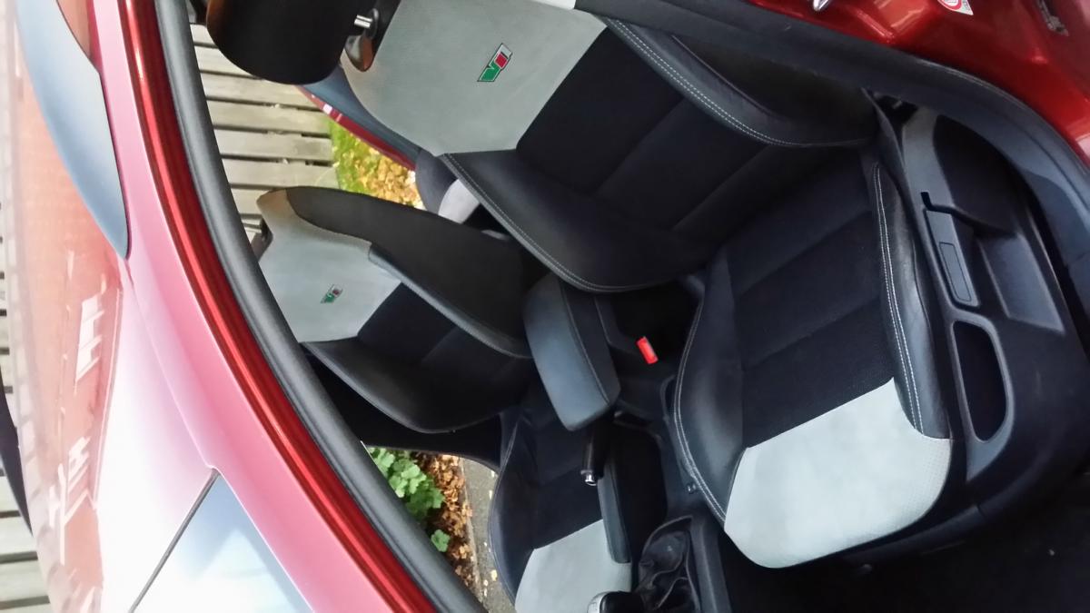

Im really happy with the new interior (even wifey has commented on how the car looks so much more presentable) but have to cut/splice the airbag connections as the Vrs seats have a totally incompatible plug connection to my loom so this is the next job over the next few days.
Well this didn't happen, having spoken to a good friend who's an independent vag mechanic I was informed that the airbags wiring loom is part of the airbags construction and not too mess with this due to possible wrangling with my insurance company if the car was ever subject to a inspection re: a claim. so I had a flash of inspiration and decided to partially disassemble the Vrs seats and remove the Incompatible airbags complete with looms and replace them with the compatible airbags/loom from my old seats.
This took about 4 hrs in total but now I have no dash light and fully functioning airbags (in the event I need them), I'm happy again dispite the razor sharp clips and edges cutting my fingers to shreds, just have to safely dispose of the spare side airbags.

Not really true on the airbag wiring loom.
Seeing as Skoda themselves had an approved dealer fix for wiring issues on the connector, which was to hard wire the airbag wiring! The connector used to sometimes fail due to the seat being adjusted back and forth.

There's a difference between a manufacturers documented fix for a fault, and a diy fix to make something fit which isn't the correct part for the car though.

Not really. The airbag system is the same. This is probably isn't a discussion for a general 'what have you done' thread, however.
All I'll say is the connectors can be swapped over, and done so safely. No errors. I had a VAG Master Tech undertake the work, in my particular case.

Yes really. A manufacturers documented fix will be designed to work with the parts in question and will be insurance approved simply because it's a manufacturers fix. A diy fix is something someone does to make stuff work, and may not necessarily follow the same rigorous investigative testing procedures. If your airbag fails to deploy (for example) in an accident and the insurers find out you've doohickeyed a fix to make the incorrect airbags fit, then you'll have no insurance. If it's a manufacturers fix then they'll have a hard job denying insurance, and even if they did you'd have recourse to the dealers for compensation.
