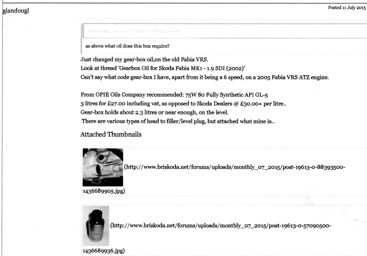

Changed my gear-box oil earlier this year, and also found Skoda wanted £90 for 3 litres of oil.
Fully Synthetic API:GL-5 75W 80 was recommende by OPIE Oils as quote ( their boss used it in his car) less notchy when cold than 75W 90.
Member below is totally correct and I concur what he has stated..
See attachments:
Mine had 75W90 put in before I bought it,gear change was notchy when cold.
Bit of research suggested 75W80 so bought some of that fully synth and gear change was transformed when cold.
Just type in 75W80 on Opie oils website and take your pick of which one you fancy :)
