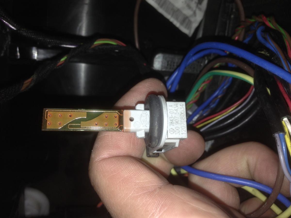

Ongoing issues with spurious wiring behind the dash in my mk2 ex police car.
A strange looking plug is hanging down with no home to go to. It looks like it would fit into an instrument cluster, but doesn't reach the main one. It has a rubber ring to create a good seal and then an electonic key-like end. Is it a temperature sensor?
Take a look at the attached and let me know if you recognise it.
The plug is marked as:
HELLA
7843-03 A
300 907 543A
1207080534
Any help would be most appreciated.
Cheers,
R.
Yup, it's a temperature sensor, although the part number starts with 3D0 not 300 ;) I'd expect a hole somewhere (in an air duct for the HVAC system) for it to fit into.
