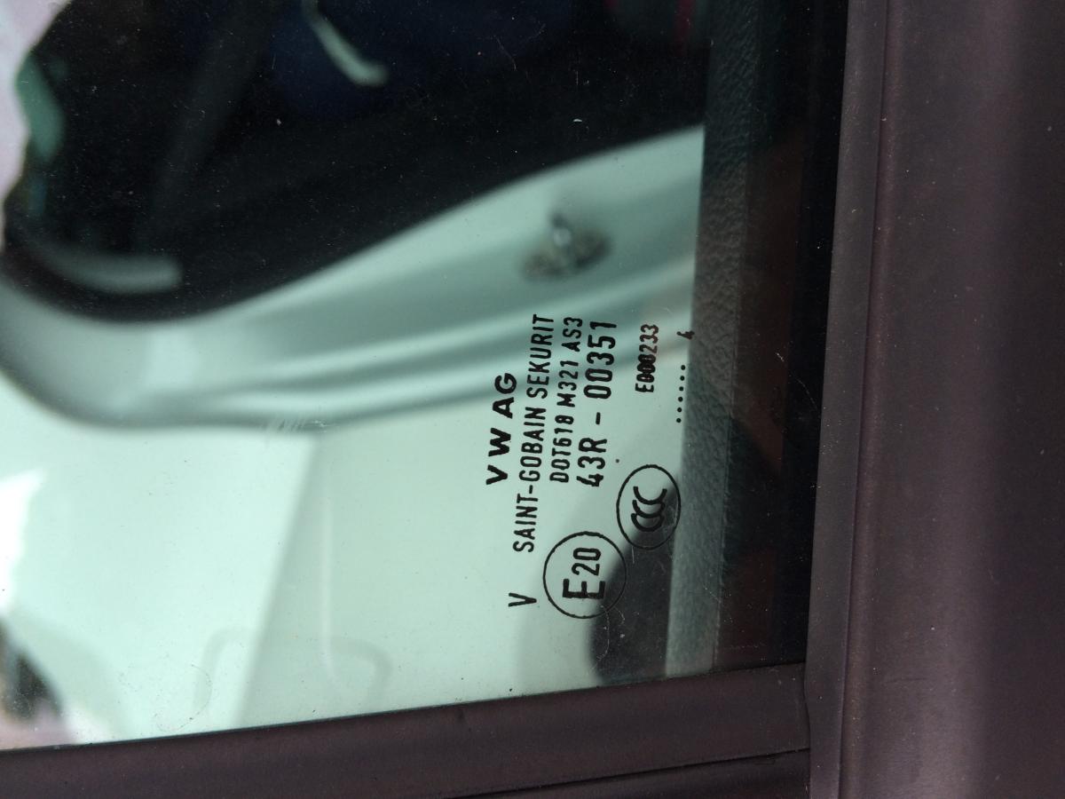

This is all I have on the window, can't see anything relating to what you said?post-131274-0-40098200-1445194847_thumb.jpeg
Looking up the full DOT info (AS3) it says it is a less than 70% light transmission, tinted glass.
So the imperfection you have is in the glass and it is not an aftermarket film.
Thanks very much, if that's true it slightly puts my mind at rest because unless you tell me otherwise the bubbles/imperfections can't grow or get any worse? What I am still bothered about is that on close inspection there are several and also on the back window too. I'm still going to speak to the dealer about it. Not that they are going to offer to replace the glass, am I mental! It's a Skoda get on with it Nels.
I'm not professing to be clever, looked it up here.
http://www.carwindshields.info/windshieldmarkings
DOT 618 is the manufacture in Poland.
AS3 = tint level
M618 = could not find but AS3 is defo the bit you needed.
If it is correct your main windscreen should be AS1 :)
