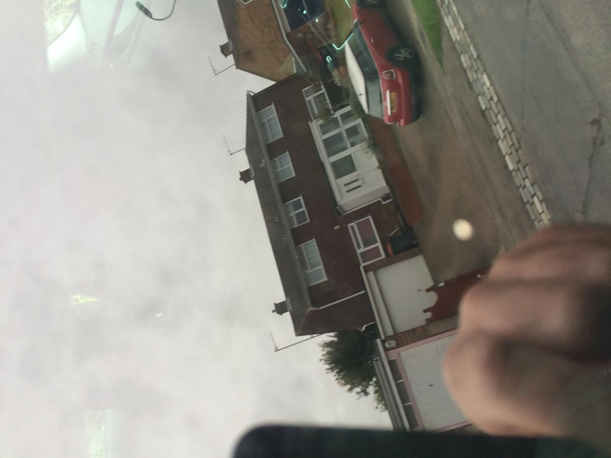

It's factory fitted I'm sure, it's a rapid sport so that's how they are made, I've tried taking pics using iPad and iPhone and all I get is a pic of me or the house accross the road, it's hard to see but it's at the top of the pic on the left about 1/3 accross. It's basically a small area which looks like an air bubble.post-131274-0-31711600-1445088465_thumb.jpegpost-131274-0-31711600-1445088465_thumb.jpeg
post-131274-0-57970200-1445088957_thumb.jpeg trying again as the pic I put up doesn't seem to open, let me know if you get it.
It's the large blob almost directly above the chimney on the left house, that's as good as I can get, my neighbours think I'm a weirdo now.
No way is that factory tinted glass - that's film that's been applied either at the dealer or at the UK landing site.
Factory glass does not use tinting film.

My back windows were very Black and nothing like in that photo. That's been an addition to the car. Sorry to read all this :(

I cant see it really in the photo--- unless someone can "ring" it.
Try taking photo from the inside.
