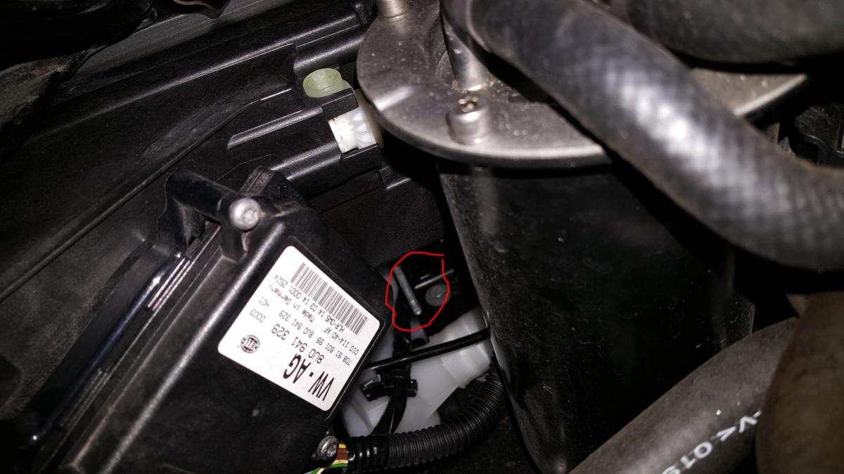

Dont worry! But do u think the adjustment screw is inside cover beside the H7 highbeam bulb?
That is logical explanation to this...cause outside housing there is only up/down and left/right adjustment screws...can you open the backside of housing and look inside with mirror?
Yup. I'm gonna try that on Friday if the weather is good :)

If you take a look behind the headlight you will see a torx head pointing out back of the headlight. Another one is placed deeper and it's not visible but you will find it by touching.
The one with a easy access is for the left/right adjustment and the one not so easy to access is for the up/down.
The tool you need is a E6 torx socket 1/4".

Don't know about the FL but pre-FL has those for assistant halogen mainbeam in bi-xenon headlights. In pre-FL you can see the sideway addjustment torx head by looking behind the headlight. It's grey, about 5-7mm long. It looks just like T25 torx head. The up/down addjustment screw is deeper and you can't see it but you can feel it with your finger. It's a tight spot but with the tool mentioned earlier you don't need to see it.I'll try to take a picture.

Is this the correct adjustment screw???
But I dont know what to use here.. It looks like a inverted torx or something.. Or is it a very very very little wrench? Maybe 3 og 4 mm? :)
I have theese on both headlights :)

Upper white plastic adjustment knobs is for up/down and lower white plastic knob is for left/right!
Yes, for the xenon. Not for the assistant halogen main beam. Trust me.
Look at the picture i uploaded. Trying to screw. Just get loose and then fasten again. Does not look like a adjuster :o
Take the back cover off and you will see the bulb housing. Try to look if there's any rods going backwards. Try to turn the screw you have already found.You might see the housing moving. The movement is very small and you easily turn it over. Can you find another screw from the headlight?
I don't have any experience from the FL and I did this for my MY2011 Superb just few weeks ago and I can confirm that the torx heads are for the halogen main beam addjustment in bi-xenon headlights. The white plastic 6mm allen screws are for the xenon addjustment.
