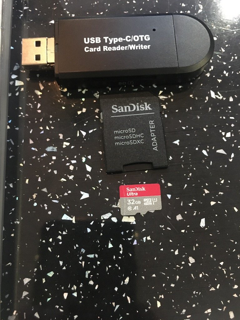

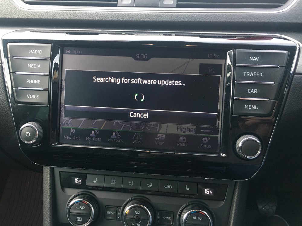

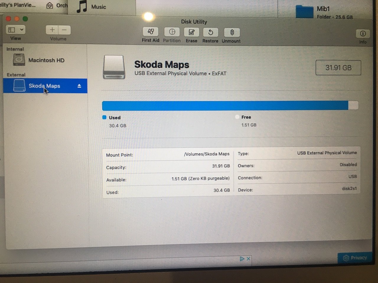

Hope somebody might be able to offer some help as I'm having issue trying to download the new maps from my SD card with no luck, I've followed the excellent guide from page 8 as I'm using a Mac, below are a couple of pictures to see if i'm doing something wrong. When I press the update button in the car I just get the message below in the photo!!

So the car car did finally stop searching for the update, but I then got the dreaded error message!

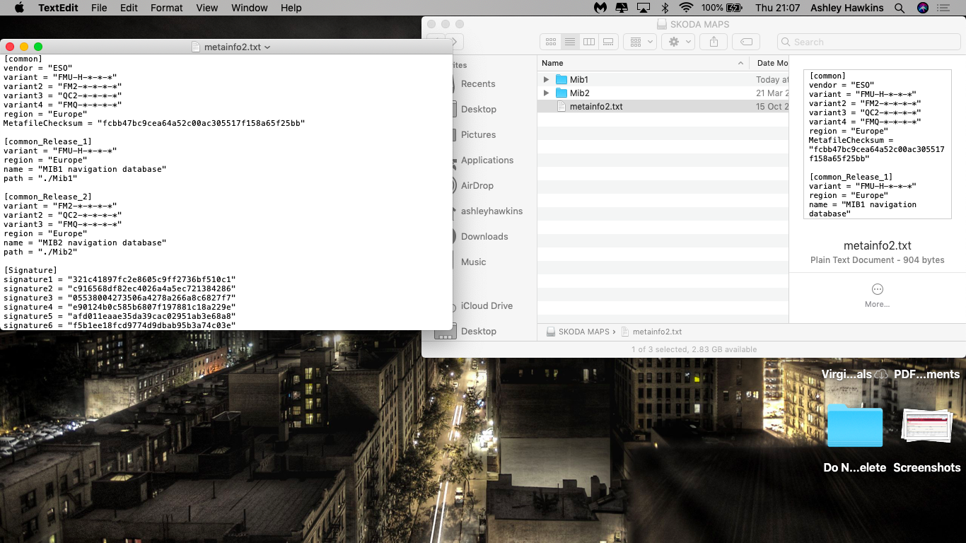

Is this my problem, if so what is needed to correct?
Regards
Ashley
No, that's not your problem. That file is correct.
Is the SD Card write-enabled when you plug it into your car? Judging by your photo the adaptor slider is in the write-enabled 'unlocked' position. The MIB unit will want to write a small file to the card but can only do this if the card is write-enabled.
If you're certain the card is really* devoid of 'invisible' MacOS system files then I would suggest using a different media (any 32GB+ SD or USB drive).
Your card name has a space character: "SKODA MAPS".  Try changing the name of the card so there's no space character by using the underscore "SKODA_MAPS".
* You can easily check this by inserting the card in your Mac with the the adaptor slide in the locked position, so the Mac can't write system files to it. Then use the Command-Shift-Period combination to check the entire card for hidden files.

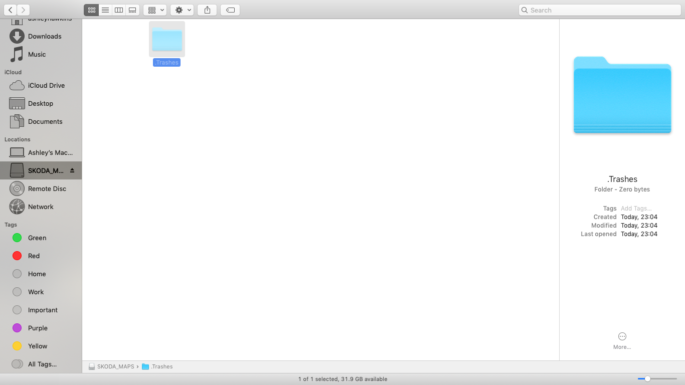

I have done as suggested and removed a couple of files to the trash can, what is left is below in the picture. I'll now try again and report back tomorrow, thanks again for taking the time in trying to assist me.

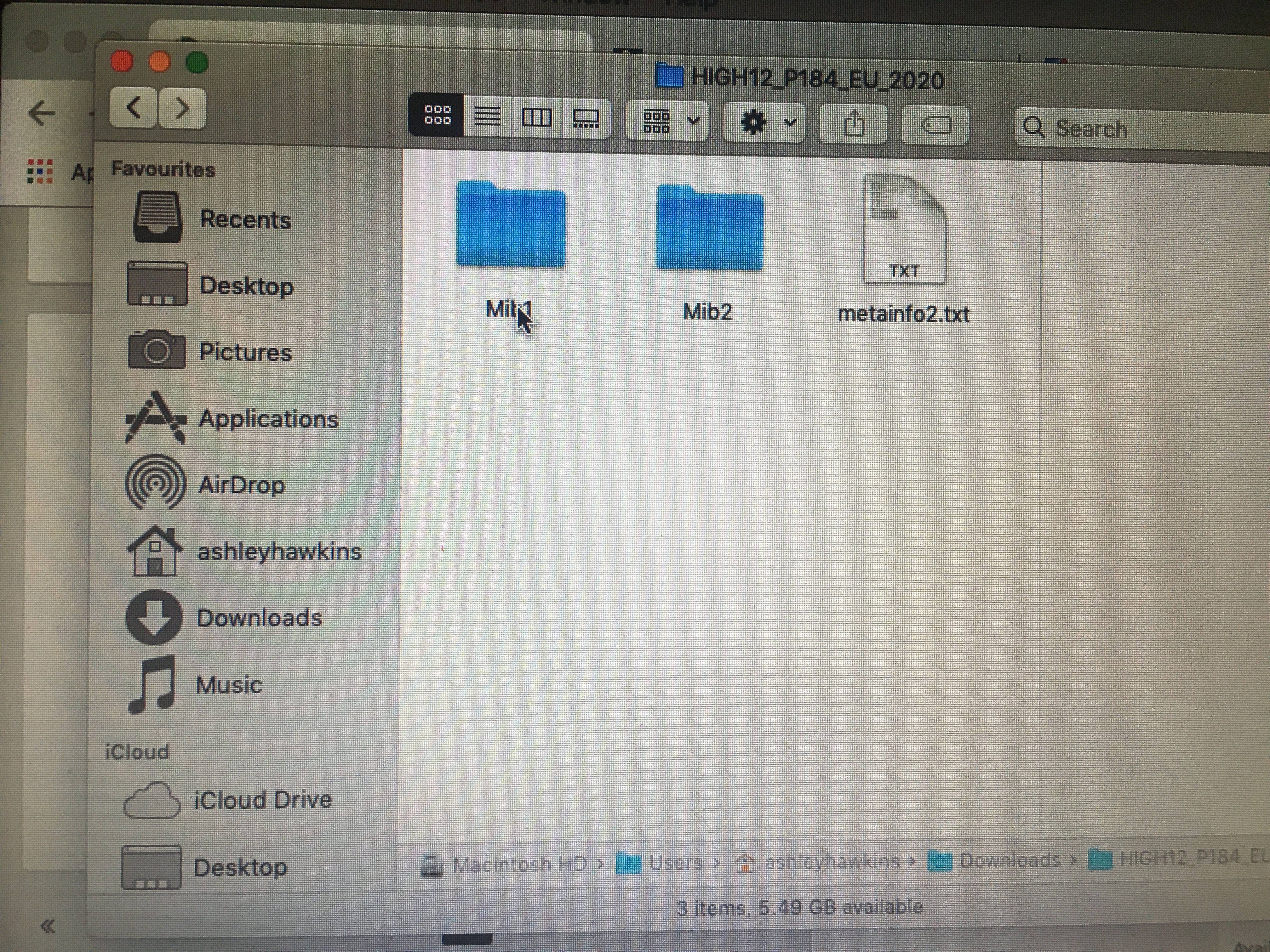

I'm currently just downloading the maps again from Skoda, I'll then do as suggested to see if thats my problem and i'll report back.
