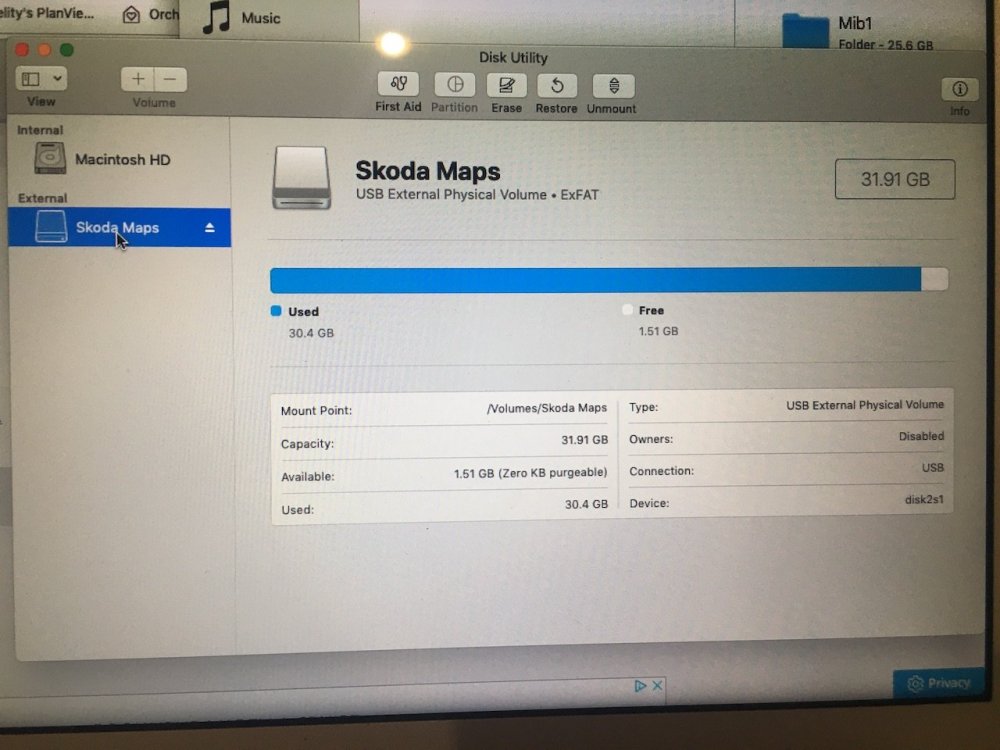

I just finished updating using Škoda's own update site, "Update Portal". Took mine 45 minutes to update, although I did interrupt the update a few times while I was also changing vehicle settings. Fortunately it resumes from the point of interruption.
Mind you Apple kit doesn't like NTFS/exFAT either.....

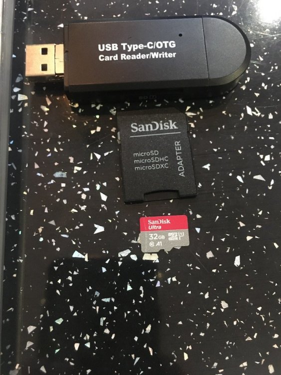

Used an iMac, exFAT formatted 128 GB class 10, no problems at all.

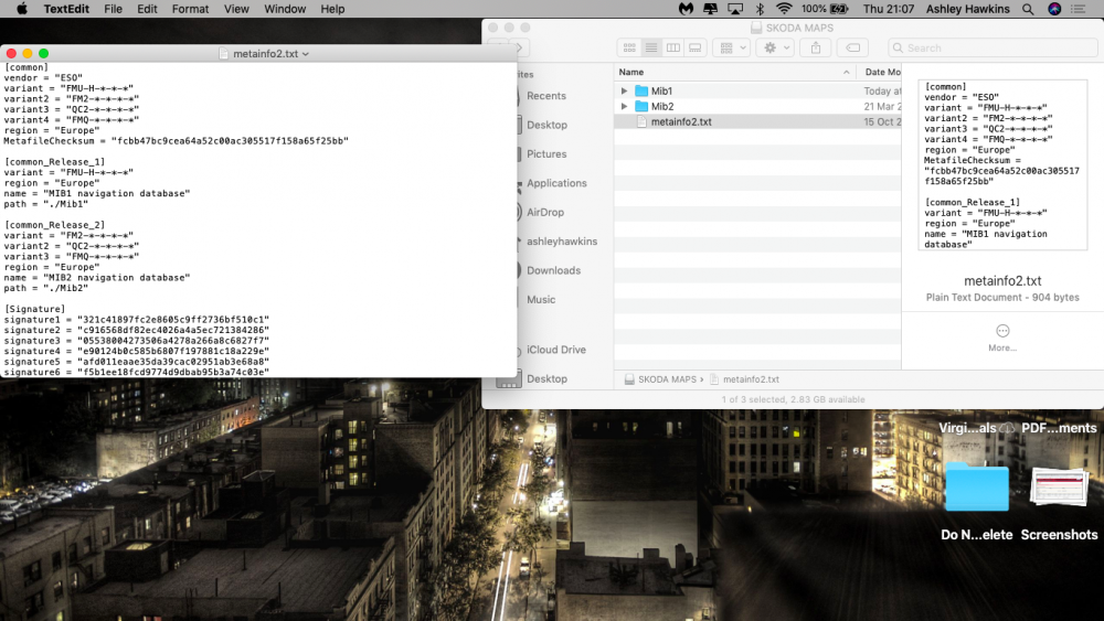

A word of advice for any Mac users;
If using Safari then ensure the Open "safe" files after downloading option in Preferences->General is not checked. Safari is not very good at extracting data that contain uncommon files, especially if the contents uses the Windows "A:xxx/yyy" drive/folder/file hierarchy.
Don't follow the Mac/Unix advice on the Škoda site about copying the Zip file to the SD Card and then extracting it. The Zip file is 24 GB and the extracted data is over 26 GB. Instead, extract the contents to your hard drive and then copy the extracted files/folders to the SD Card.
For this update your SD Card should have a file titled metainfo2.txt and two folders titled Mib1 and Mib2.
