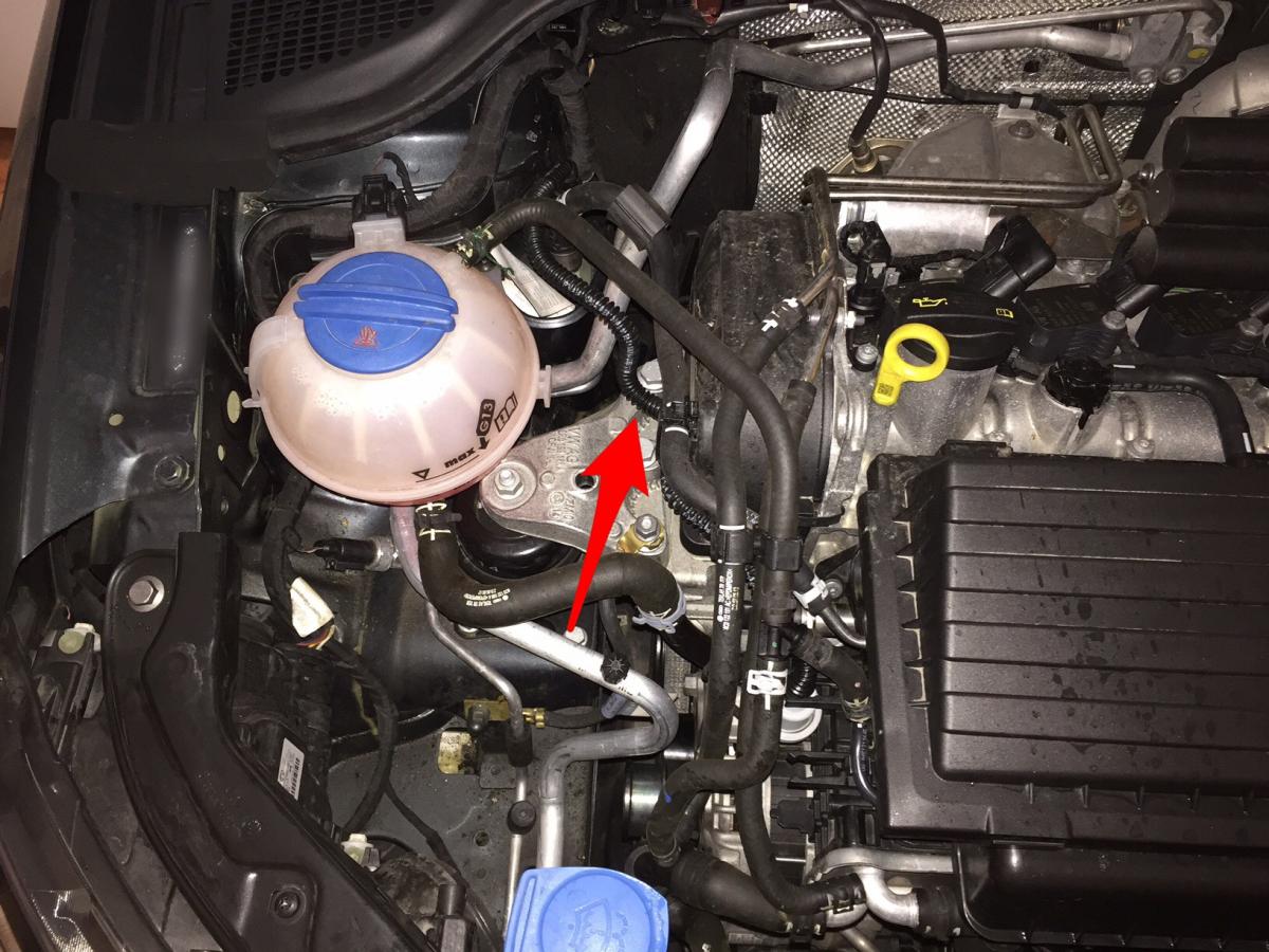

Update: I got the charcoal canister hose replaced the other day and the beeping / high pitched noise is now finally gone! The original hose was ribbed (and plastic, I believe), while the new one smooth and made of rubber. The mechanic took the old hose into his hand and blew through it -- and you could hear it produce a loud noise, while blowing through the new hose does not produce any sound (only a slight hush of the air).
Many thanks to the users kristianRS and kimmu for the heads-up on this.
Edited by jon15
This is the hose they replaced:
