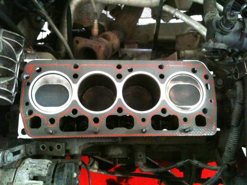

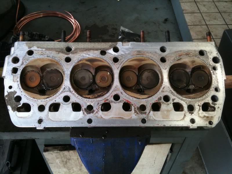

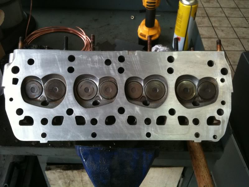

I have changed many MPi head gaskets without reworking the cylinder head. Checked with a straight edge and feeler gauge and have found minimal distortion. Fitted a genuine gasket and all has been well.
Do have to watch for a bit of corrosion around the water ways now as they are getting older though.
Head cleaned up, checked as ok and new gasket fitted.
