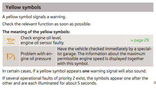

Is it following symbols (taken from page 21 of https://mediaportal.skoda-auto.com/resource/documentation/manuals/en/octavia/05-2012/manual/a5_octavia_ownersmanual.pdf ):
If so, it looks like an oil pressure problem.
I'd check the oil level just to make sure it's not low and the either take it to a dealer or a garage that has diagnostic equipment to diagnose the problem. Probably sooner rather than later as low pressure won't do your engine any favours.
Yes its the second of the two icons. Thanks for your input.
