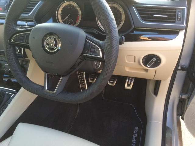

Ok bought me a flat bottom steer wheel, seen how to fit it on standard ignition but how do you fit to a kessy ignition? surely after disconnecting the battery it will just lock the wheel.

Release the airbag clips that locate it to the wheel 1st then remove the battery terminal.
It is then a simple plug and play, I personally reused my steering wheel buttons as the Superb has a different button (for the driver assists)
Okay thanks for that, mine is mk3 wheel so straight swap
Check the top left button on the r/h side as mine was also for a MKIII Octavia vRS.

Can you supply the link to what you have ordered as the link Phil posted shows the button mine came with (the one above the phone... the voice control one)
Whereas the my Superb has this one, which is for the driver assists:
Does that voice control button still operate the driver assist?
Wheel looks really good btw
Thanks,
Not sure if the voice control will operate the driver assist.
The buttons (c/w gloss black frame that goes around the bottom of the airbag is simply pushed onto the wheel, so really easy to change.

Mine does not have white stiching it's black and no vrs badge just standard, will post picture when fitted.
Wheel fitted, car remapped one happy teddy! the right hand button is voice control not smart assist and I checked to see it was the same! its old age or love for the wheel..
