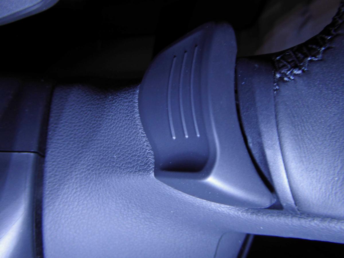

Nick, could you kindly upload a pic of what the back of the paddles look like? For £16 delivered I think these might be worth trying out for me.
Here you go... Sorry about the poor quality.
No that's perfect thanks Nick. They should be the same fixture then as with the VW paddles. Have ordered a brushed metal grey pair to match the SEL Exec panels so let's see how they look! Will keep you all posted.
