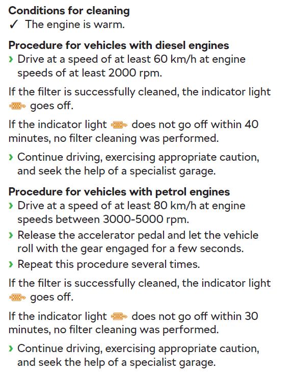

Not sure about behaviour of vehicle, but instructions on assisting a regen are different for petrol. In particular the bit that says release the accelerator pedal and let the vehicle roll with the gear engaged for a few seconds, and repeat several times.
Up to now the advice commonly given to prospective buyers has been not to buy a diesel if trips are mainly short and urban. I am wondering what advice will be given to prospective buyers of petrol cars in future if they are all going to be fitted with gpfs.
^^^Yep I had the instructions down already, cheers though 👍
Was just interested to see how the engine might behaved during a regen if anyone knew of the characteristics.

Basically they have to "blow through" of the throttle (as above at 3000>5000rpm) to ignite and burn away the soot.
