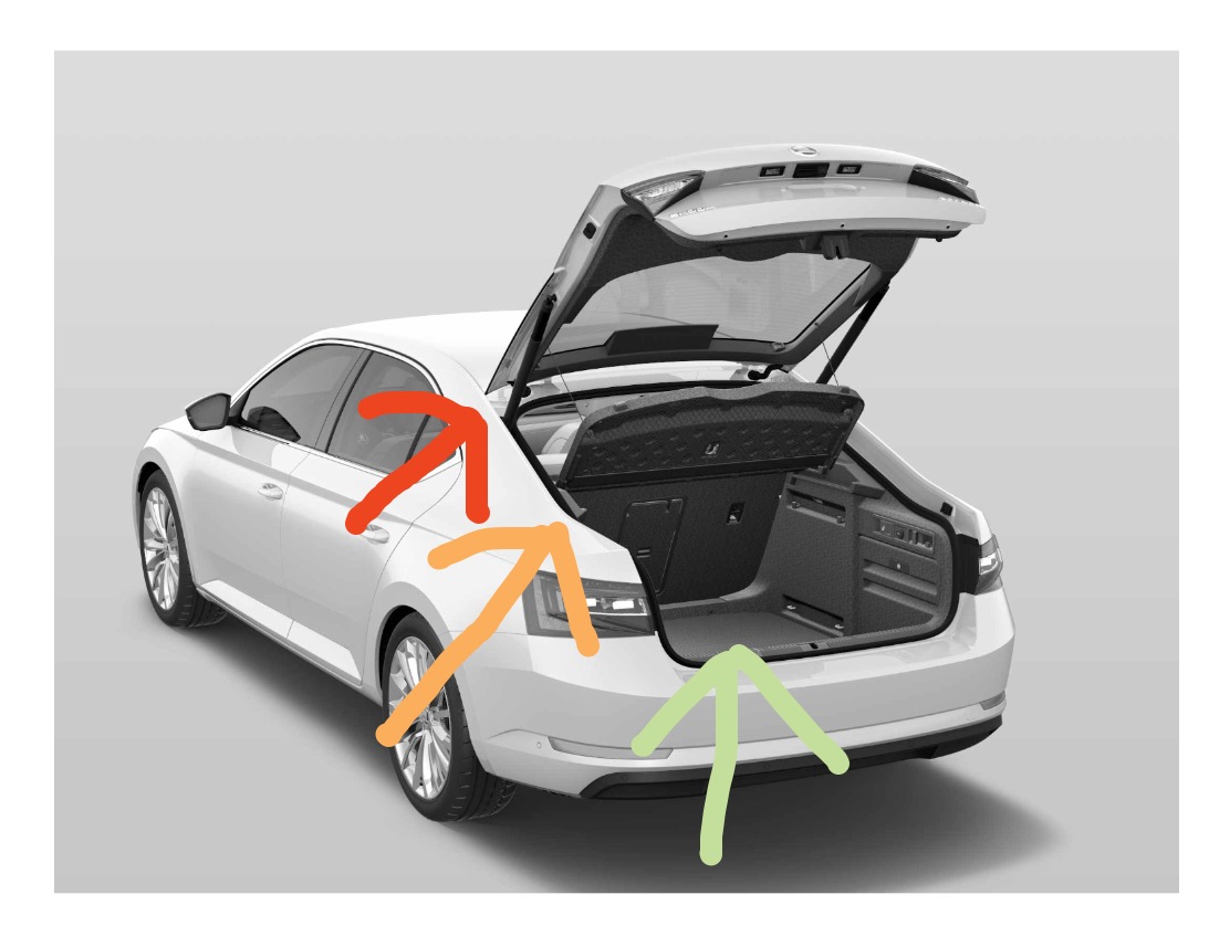

    Okay, testing complete. Dinner tonight will be minus one carrot unless I replace it pronto... Please note the attached findings are not scientifically sound, may vary between cars and shouldn't repla

Just did some tests :)
On my hatch, it stops when I hold one hand out and apply moderate resistance. I can stop it with ease one-handed, and certainly a great deal easier than as demonstrated in the video above.
It also seems to use the KESSY virtual pedal sensor as when I stand very close and press the button to lower the lid, it stops almost instantly with a 'chirp'. The same doesn't happen if I stand a little further back.
I think the greatest danger would be to small hands placed high up toward the hinge - the force there is much greater. I haven't been brave enough to offer my fingers up for science, but I may attempt it with a carrot or similar :)

Okay, testing complete. Dinner tonight will be minus one carrot unless I replace it pronto... Please note the attached findings are not scientifically sound, may vary between cars and shouldn't replace normal caution and care.
The good news is that for most of the boot the damage to most fingers, hands and other parts would be low... However, as suspected, a stray small person hand placed inadvertently at the top end of an electrically closing hatch boot would carry a high probability of injury.
The expertly annotated diagram attached should show the danger points. The red zone (above the anchor point for the damper) is small - maybe 6 inches or so - but resulted in the end of the carrot being chopped off and the boot closing. Completely. The amber zone (most of the sides of the lid) resulted in minor crush damage to the carrot, but boot lid stopping. The green zone (rear lip) resulted in much the same as the Amber, but with less visible damage to the carrot.
Now, a carrot is not a medically approved substitute for a finger, and the age of the person will have a great bearing on the results, but I know I'm going to be continue to be incredibly careful with my kids (toddlers) and warn them of the dangers.
