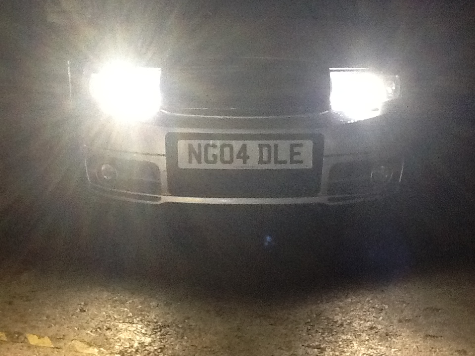

Looking at the car from the outside they have a slight blue tint to them. Obviously the camera just makes them look a blurred/glary mess but they're not like that with the eye;

I've purchased a 35w 6000k canbus friendly hid kit for now, will of course put before and after pictures against my garage door or somthing

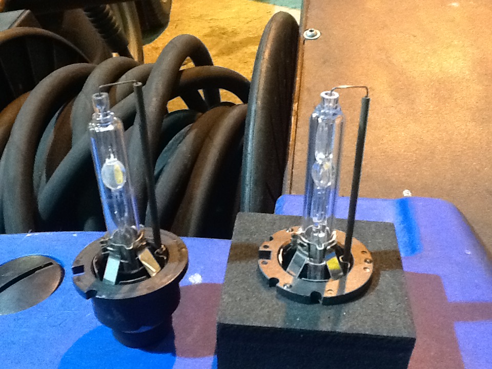

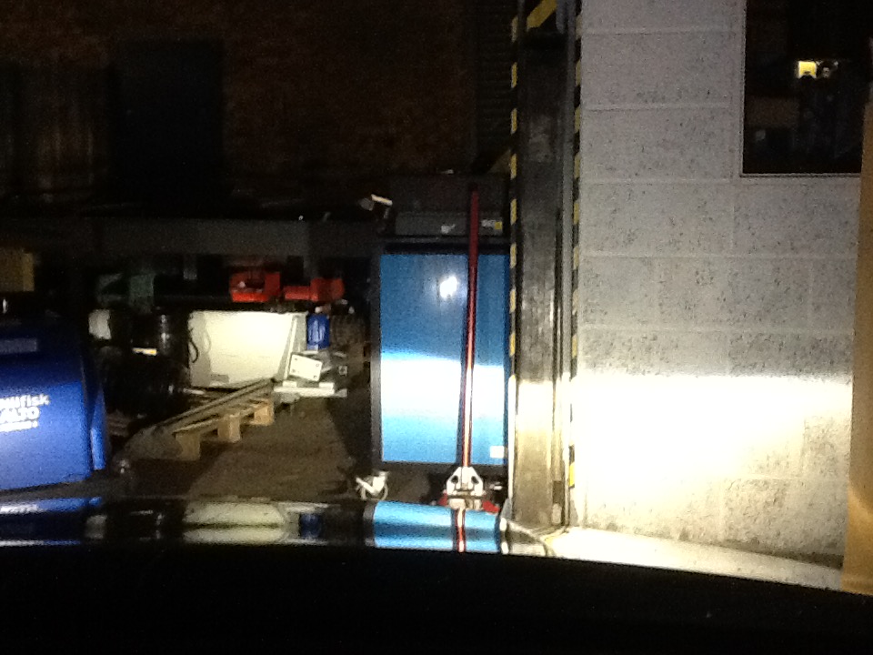

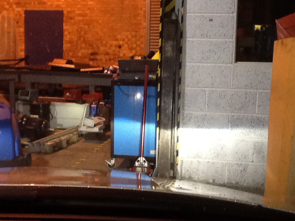

Here's a couple of pics of me replacing the drivers side xenon from a factory Philips bulb to a Morimoto xb35 4500k.
The first pic is the original the second is a pic of the new bulb as you can see it's defiantly brighter and more intense than the new bulb, the third is a side by side comparison of the actual bulbs.
My camera isn't the best unfortunately but it gives you an idea of the color from a 4500k bulb. I'll upload them probably to photo bucket when I have a chance which will increase the resolution of the photos to make them a bit clearer.

they look a lot brighter, i think mine have been in since new so due a change
They are without a doubt brighter than what was in there how much brighter they are than a normal bulbs is difficult to tell as my bulbs were probably well over due a replacement.
