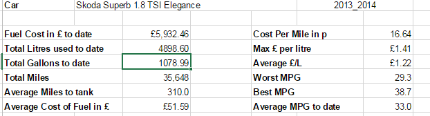

The actual costs over the time of the car aren't worth changing it. I do 15k a year in a 1.8TSI and since owning it averaged 33MPG (recorded brim to brim method). See attached for the stats.
I do 30 miles each way to work and back, with 18 roundabouts (!) each way! The TSI is 10MPG down on my old 2.0PD 140 Octavia but is much more pleasurable engine to drive with. Happy to rev, nice spread of torque and power, responsive and quiet when its needed to be. It has also been (touches wood) cheaper to run overall than my previous diesel cars as the maintenance costs are coming out at less.
The Fabia 1.2TSI we now have is about as economical for my wife to drive to work as her previous mk1 Fabia vRS. And its not that much slower in the driving she does. But the insurance is lower and actually cheaper to tax and service!
Personally I can't see me heading back to diesel any time soon. Petrol is much nicer to drive imo.
Very methodical work there!
