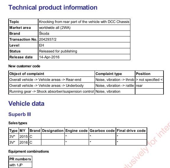

This was a known issue with early models especially those with DCC. All the inof is in this thread. There was a Tech Service Bulletin issued in about Apr/May 2016 but as I have since sold that vehicle I cnat tell you the number. Copied below is info that posted from Sweden when this was all over the forum. My guess is your car was never modified as it was a service call and not a safety recall.
Good luck and hth

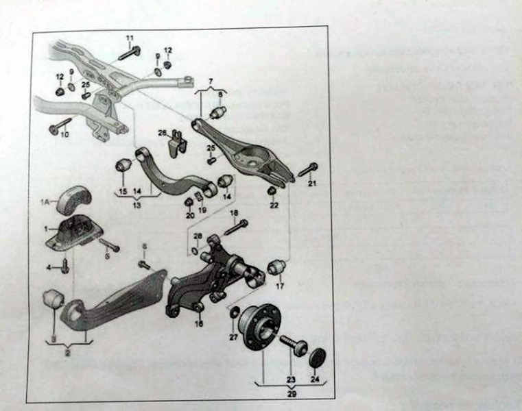

The rattling noise in the rear depends on a faulty casting of the wishbone bushings.
In a certain period of manufacturing, there were bubbles of air in the rubber mixture, which can give a rattling noise in the rear.
The fault only affect cars with adjustable DCC chassis, and only during a certain period of manufacturing.
Skoda has now developed a new type of bushing to solve the issue. The new bushings have a green, yellow or blue marking on them.
You take away the wishbones in the back, pressing out the faulty bushings and replace them with new ones. After this, the car's wheel angles are adjusted.
It's part number 3 in the picture below that is replaced.
You loosen the bolts 4, 5 and 6 to have the wishbone free. Screws number 4 is adjustable to be able to change the rears toe-in. Therefor, a wheel angle adjustment is needed.

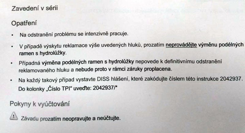

Check this out

Ta Deerjohn for the useful pic and technical bulletin details.
This is exactly the work I had done on our car. We had the trailing arm bush (item 3 in the pic) replaced and this made a huge difference. Previously we'd had a fairly constant clunking from the rear of the car. Now, we're just left with a noise similar to the one in ChaybobbTidbit's videos. Only really occurs when we hit a large speedbump  type thing and seems to come from the front.
