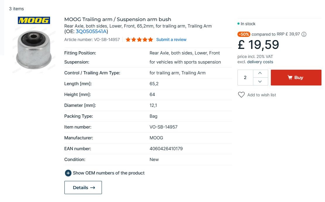

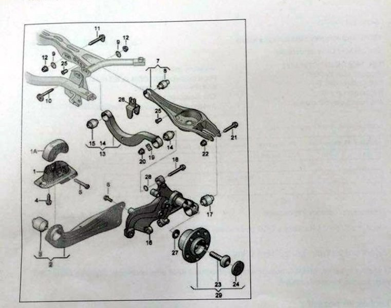

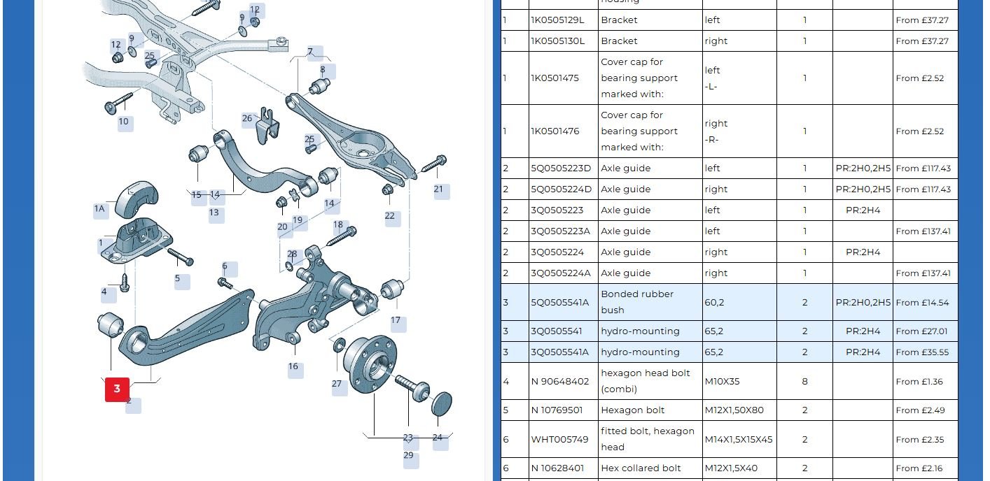

Hi all, sorry to revive an old thread, it looks like this issue was solved by fitting the updated / redesigned trailing arm hydro-bushes 3Q0505541A as below, is that correct ?
My newly acquired MY2017 DCC car has a soft knocking from the rear over small bumps / uneven surfaces so i guess it's likely this.
