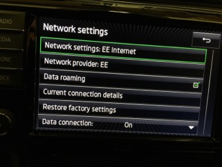

I had the Premium WLAN with integrated high-speed LTE internet option fitted to my SEL EXEC, I have only just got around to purchasing an EE Data Sim on Saturday, I have tried to set up the Mobile Hot Spot but without success, I have read through the Columbus Manual and followed the instructions, the EE Sim is recognised, I have attached a picture of the Network Setting Screen.

Quick update,
I have managed to get the Premium WLAN with integrated high-speed LTE internet working, the first issue was to change some settings in the Columbus Network Settings Menu, with the EE Data SIM I had to delete the information in Usurer Name & Password, as below.
"User Name" this should be left blank.
​"Password", this should also be left blank.
Ensure that you Enter and save any changes.
When you search for available Wi-Fi Networks on your external device, such as an iPad and you find the Wi-Fi network, in my case Skoda WLAN_0179_, you click on connect, a password request box will appear, you are asked for a password for the accessed network, the Pass word in my case was the "Network Key" in the Network Menu, ensure you enter this data exactly in the password box and enter.
All being well, your iPad or Laptop will connect to your Skoda Wi-Fi Network, I checked my Download & Upload Speeds tonight, 32Gig down and 20Gig Upload, not bad.
I hope this helps for any other poor non techies like me get set up, obviously the setting may differ for other Data SIM Providers.
