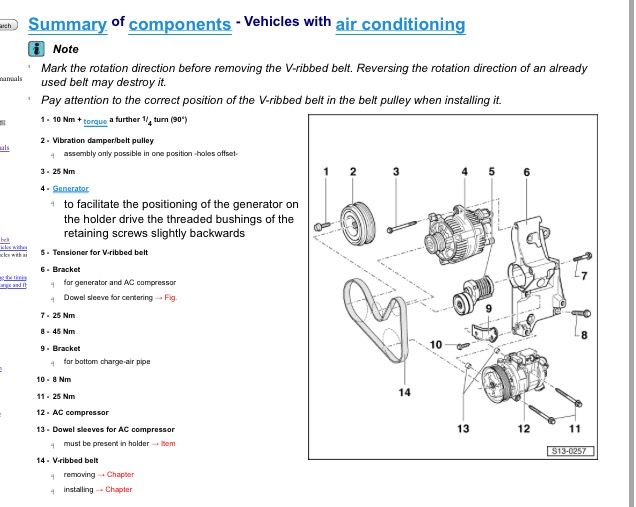

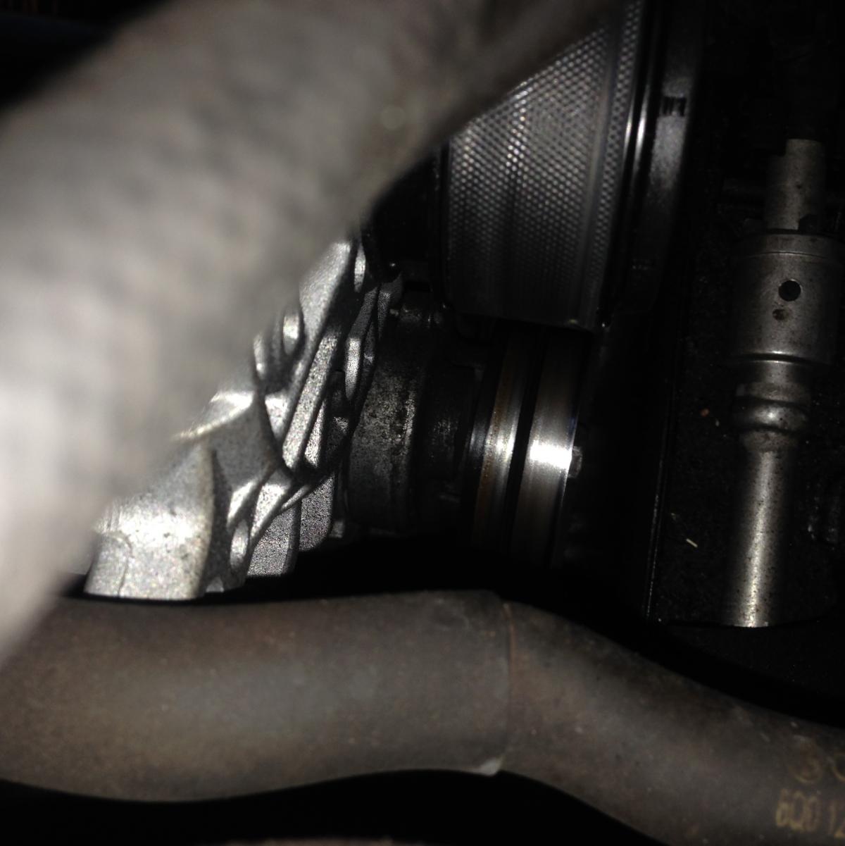

maybe ive got this wrong then, its the wheel just below the alternator
this is the wheel without the belt
Edited by bluepassion
You have the air con compressor below the alternator.
That's the tensioner.
it's number 5 the tensioner
Could be, but doesn't list engine variant.

It's a plastic pattern part because VAG only sell the tensioner assembly complete with pulley, it's held on by a left-hand threaded bolt. It's a cheap fix, I removed mine, flicked out the bearing seals, then cleaned and regreased the ball race. Still nice and quiet.
