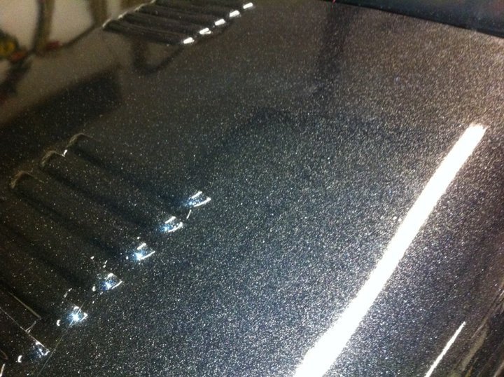

Anyone have any experiance or advice about wrapping a roof i am getting a bit fed up with the white to hard to keep clean hopefully going to try and diy the roof glitter black.

I had mine done black magic along with the front grille B pillars and fog surrounds £190 in total it was 3m 1080 at L W graphics in Bradford DSC00152.jpg
