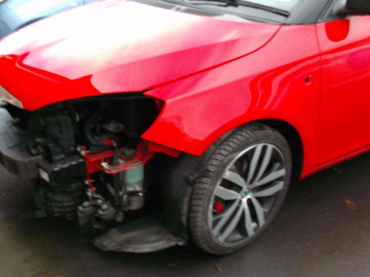

Removing front wing liner
Can anyone tell me how the front wheel arch liners are fixed before I start struggling?
Thanks for any help or directions to an instruction sheet.

At some point I want to replace the damaged N/S front wing and am looking at doing it myself.
