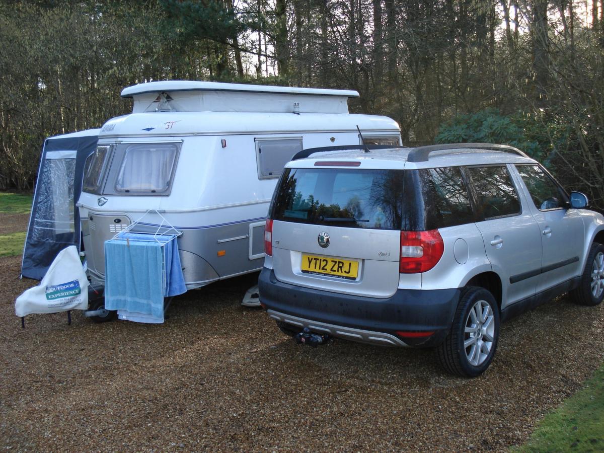

I have towed our Hobby 560 caravan (weight=1500kg) with both my Yeti's, the only hassle was the extra width of the caravan needing WIDE mirrors.
140 4x4 and the 170 4x4.
No problems except on a flooded field when a tractor had to tow us off.
Sits at max speed 60 fine, with mpg=29.
Just look ahead and brake steady (basic towing theory)
As i said it tows my caravan beautifully, I collected it from the dealer,
hitched up and went to the CC Sandringham estate. It drove beautifully
hitch weight 80kg. but I kept it to around 60kg. noseweight with this caravan.post-102023-0-61439200-1454694419_thumb.jpg
