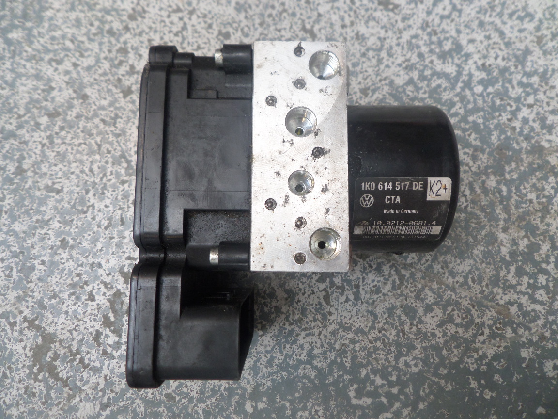

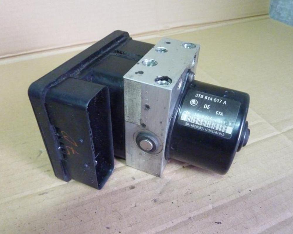

Assuming these pictures are correct it looks like this is the case.
3T0907379A
1K0907379BJ
Edit:
Just to avoid confusion, it's the centre two connections have switched sized:
- On the MK60 it's large, small, large, large
- On the MK60EC1 it's large, large, small, large
I think the other two connections which aren't shown stay the same.
