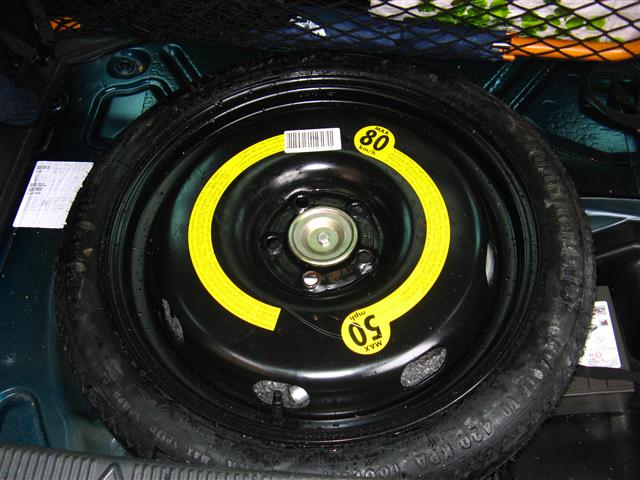

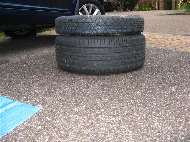

Recently I started considered whether I should have a spare wheel. I got my Yeti in Feb 2014 and decided against the spare wheel option, partly because of the space it takes up, partly because of the cost. Anyway, scroll forward 2 years and, although I haven't had to use the gunk kit, I was thinking that it could be a pain, especially in the dark on the motorway and obviously no use if the tyre has more than a simple hole in it. I still don't much like Skoda's prices and I also still don't fancy losing the space taken up by a full sized wheel, so I compromised and found an 18" Golf Mk5 space saver wheel and tyre, with toolkit (because I need the jack now!) for £60 delivered on ebay. It is a 125/70/18 tyre which has almost exactly the same rolling diameter as the Scudo alloy wheel/tyre combo I have on

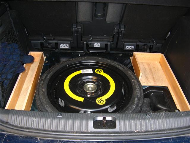

A few hours of tinkering later and for no additional cost (because I had the bits and pieces lying around) I now have a space saver wheel in my boot with raised floor. Summary:

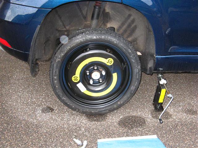

  • test fitted the wheel to make absolutely sure it is the right PCD ;)

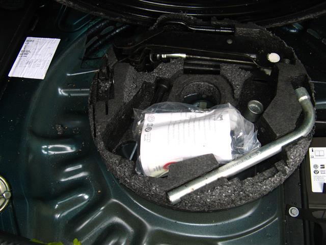

  • cut the polystyrene toolkit holder down so it fits under the wheel instead of on top, since that's the least space-using way of fitting the wheel in the Yeti's boot

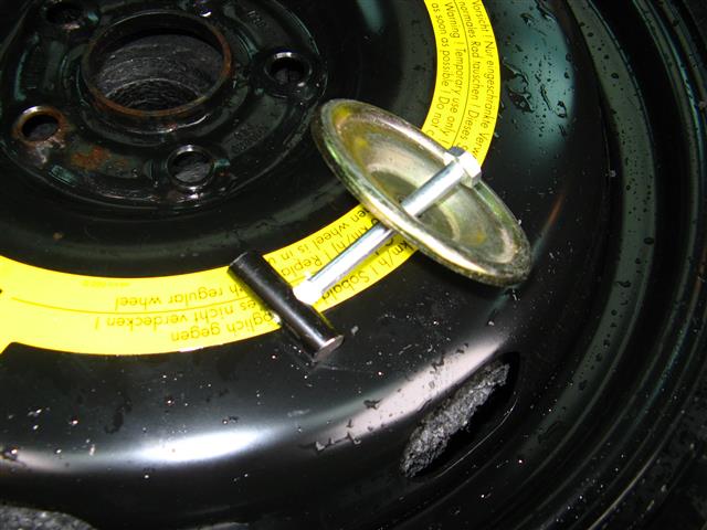

  • made a fixing bolt from the big washer from an MX5 spare wheel bolt, a standard bolt and a piece of steel bar, threaded to take the bolt. I also cut the end off the handle from an old office chair, as it has a hexagonal inside suitable for easy turning of the bolt head and saves having to faff around with a spanner.
  • made left and right supports/storage boxes from plywood and wood from some dismantled drawers.
  • boxes have holes drilled to fit on the threaded studs on the boot floor. The right hand one is additionally held down with a steel tab using one of the OEM plastic box fixing bolts.

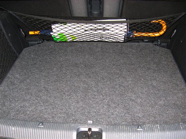

I left the small net on the left attached to the bottom loops but the one across the backs of the seats I attached to the seats themselves, otherwise it would be a pain to remove.
I was going to put some plywood on top but since I have the optional double sided boot mat, I decided just to refit the carpet and put the boot on top. If it turns out not to be solid enough, I will put some plywood on top. I had to unclip the original boot carpet at the front edge, but it still just about tucks under the plastic trim OK.
I've left the compressor and gunk in there for the time being...
At some point, I may put some carpeting inside the boxes to stop stuff making a noise when rattling around.
The next result is that the new floor is only <=9cm higher than the old one

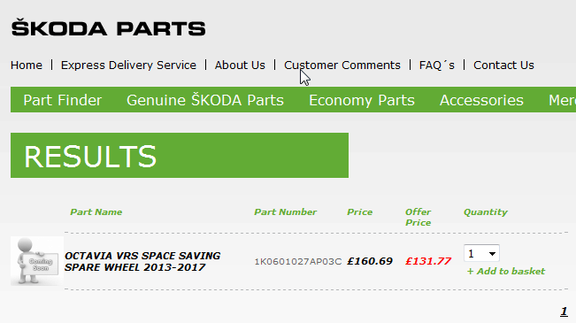

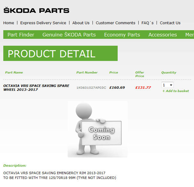

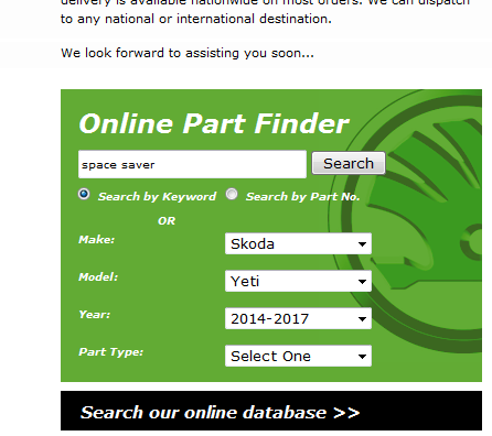

Several places are selling that width of spare tyre as being for Yeti e.g. this and this. I did a search on www.skodaparts.com and it came up with what looks like exactly the same combo (though it does say Octavia VRS...)

Neither of the ones in your link are legal for fitment to a Yeti!
And the screenshots both say Octavia!
Just because a retailer says something fits does not make it correct or legal.
