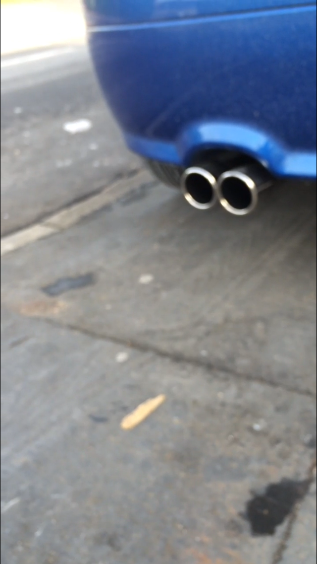

As for the system it's not very loud, slightly dissapointed. Also looks to be hanging 20-25 from the bumper where I've seen some peoples and it's tight to the bumper, I want mine tight.
I've seen people have bent their rear hangar down to in turn bring the backbox up, is that what I'm going to have to do?

Here's a screenshot of a video I took, can you see it looks like it's hanging a bit?

It's not surprising they are quiet really,the back box is fookin massive!
Even with 2.5bar of boost and a 2260 mine with a 4 diameter box is still pretty quiet.
I had to alter the brackets slightly and found the further you push the backbox into the centre section the closer it sits to the bumper.
Mine sits almost perfect with a very small 2mm around the edge so happy enough.
