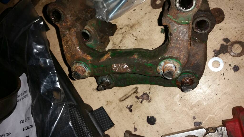

*Couldn't fit rears as carrier bolts were solid and corroded! So had to get some bolt removers and will crack on this week.

Your going to need a angle grinder and new bolts mate. just doing the rear 256mm upgrade on mine and no way in hell the bolts will move. Was a right chew on!
http://pages.ebay.com/link/?nav=item.view&id=231388117504&alt=web
Those are the bolts you need buddy. Alot cheaper than TPS at nearly 4 quid a bolt!

You don't need to remove the rear carrier to change the discs and pads :)

I've got new bolts and hoping the old ones come off with some heat and these Irwin bolt removers I've acquired!
We shall see though - I'm not holding my breath lol.
Good luck mate.. heat mite help you win. I wasted a good hour off my life trying all the useual removal tricks. Angle griner and a hammer and its a 5mim job :)
I just use a power bar with the Allen key and they always come off. Very bloody tight but they always come off.
As said above, don't need to come off for discs and pads anyway :)
All 4 of mine the heads stripped out, even with the allen hammered well in. Yer i hope he is upgrading to 256mm [emoji3] [emoji3]

Lol.. no just a simple change! But I was giving my disc some with a rubber mallet and pressure and it wasn't budging- which is what led me to the carriers..
I'll give it a good smash!

In that case, dont use the angle grinder what ever you do! Ditch the rubber mallet and switch out for a ball pein followed by lump hammer if no joy!
Yep, a bit plus gas or wd40 etc around the rear of the disc, around the wheel bolt holes and the centre bore, leave it for 10 minutes and smash it to bits with a mash hammer.
I remember on one car, I hammerd two of my chisels on the top and bottom of the carrier between the disc so it had a lot of constant force pulling the disc away and impacted it a few times and it pulled away.
