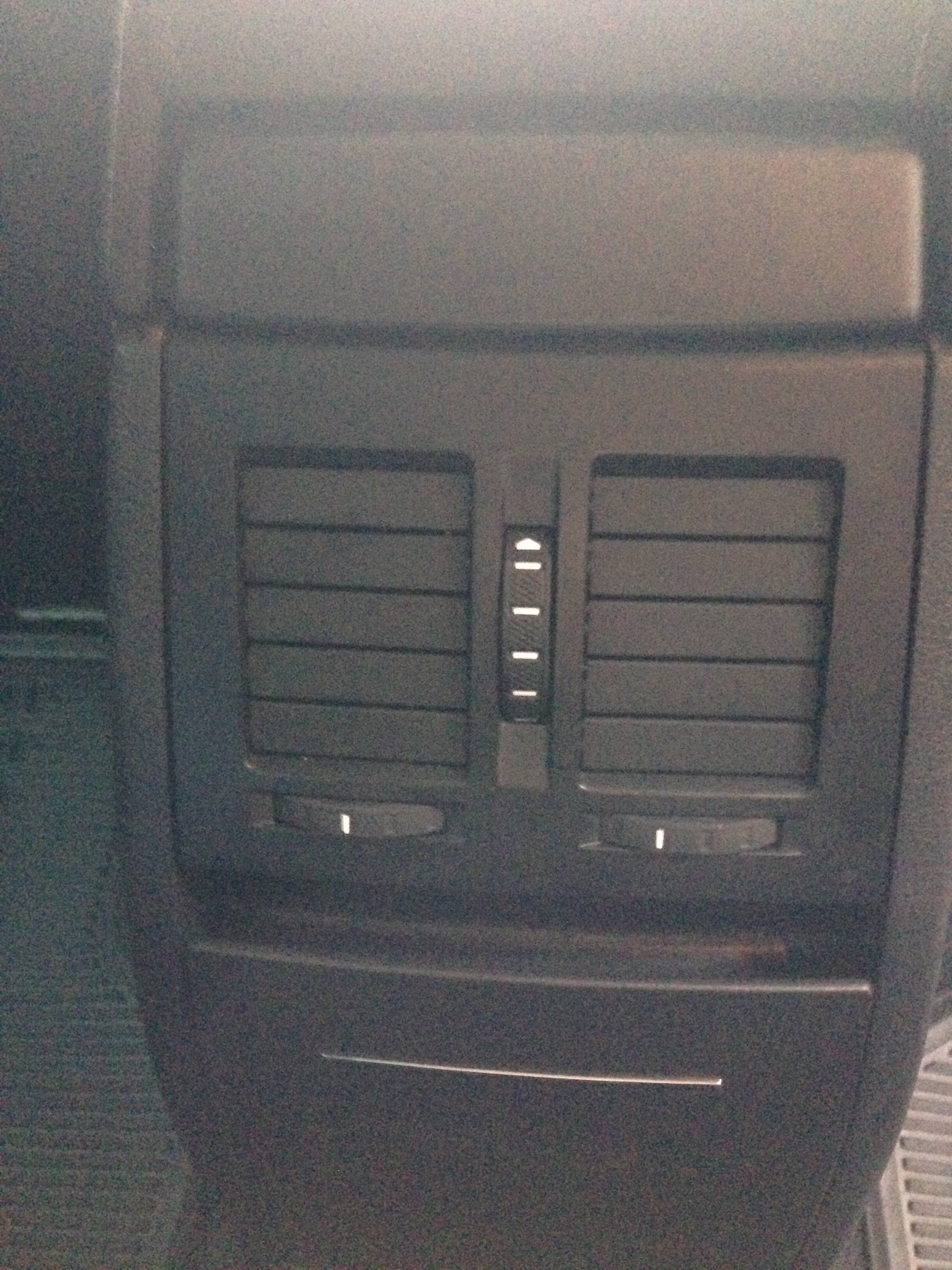

Does anyone know how to remove the rear heater vents, the ones at the back of the arm rest for the rear passengers? It's on a FL Yeti SE.
The wheel that should open and close the vents will not move at all and one is stuck half open and the other completely closed.
Any one had this problem before or can offer advice would be helpful :)
Many thanks.
Photo of vents -

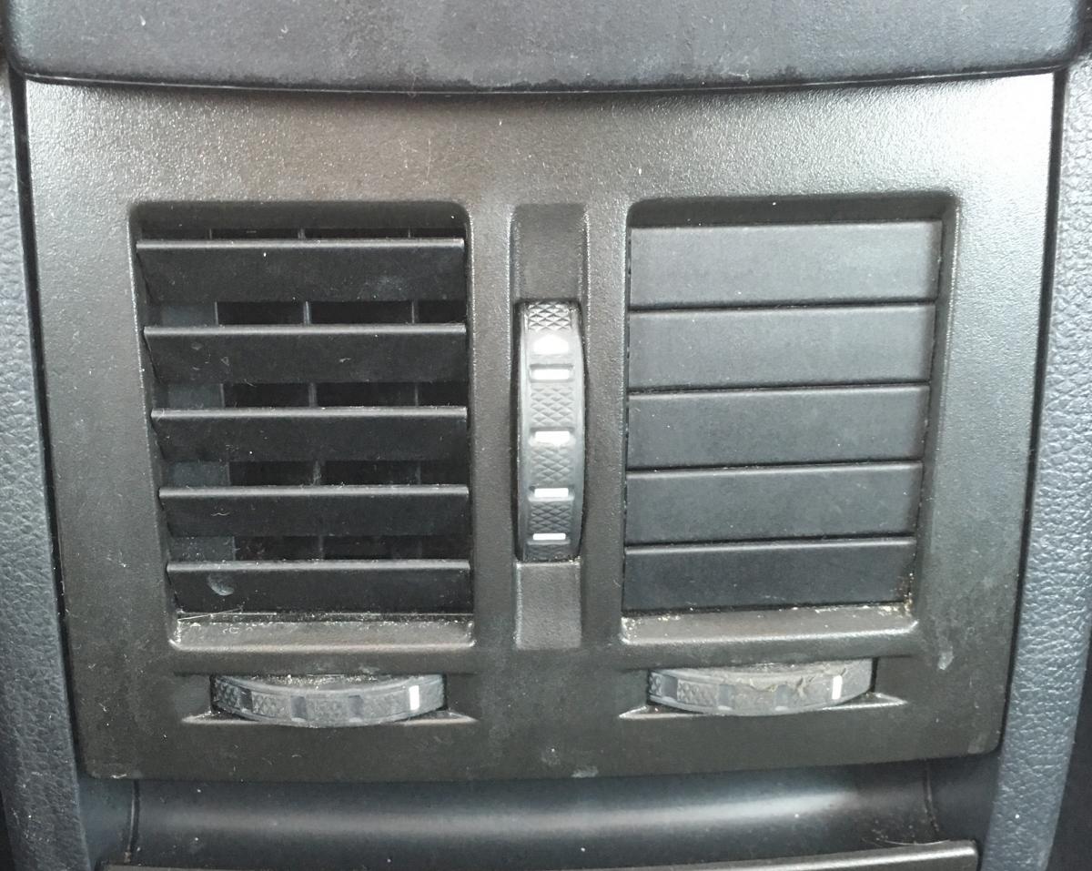

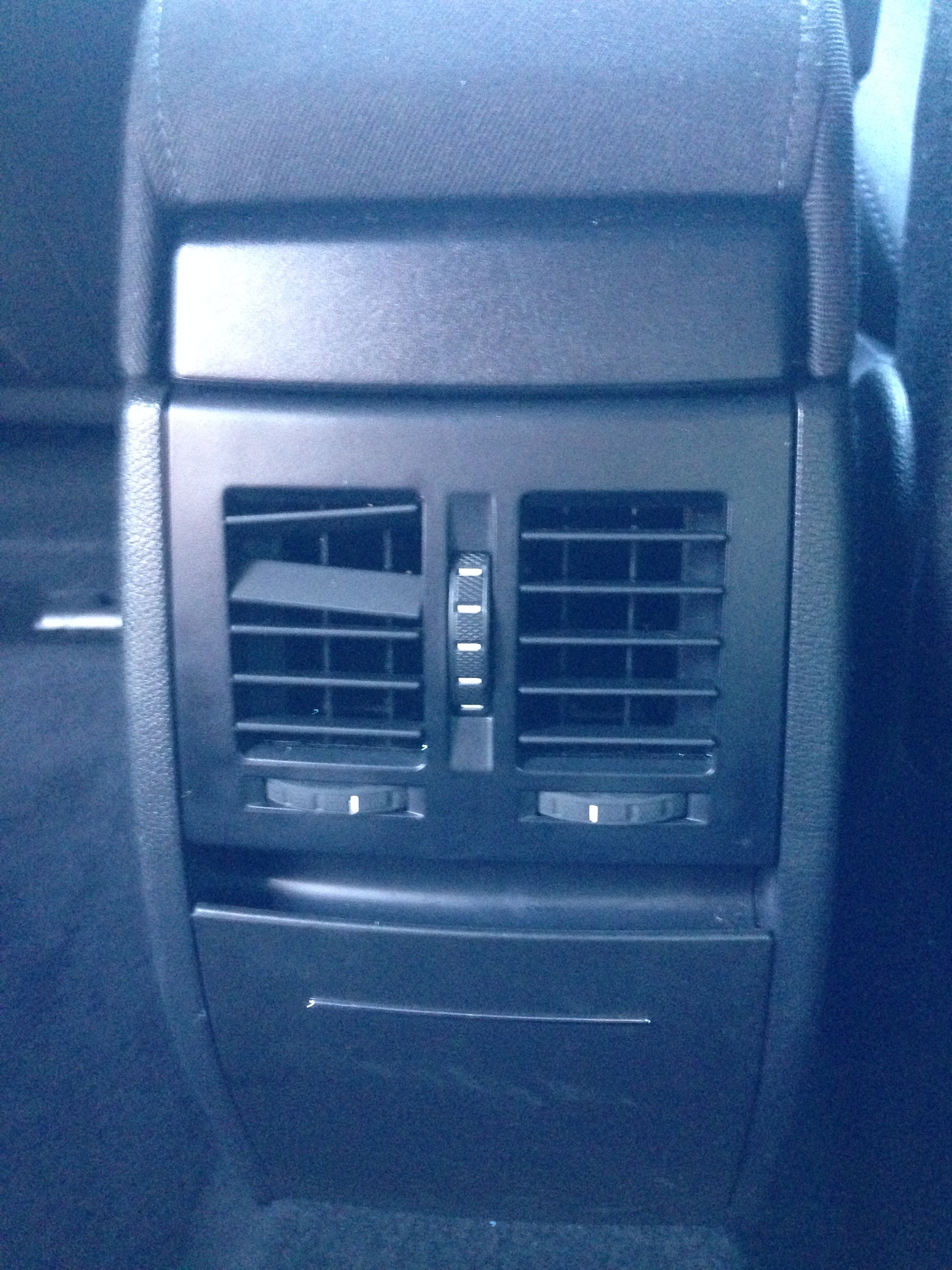

My heavy footed kids managed to damage a couple of the louvres on the rear heater vent of our Yeti.
I simply popped it out with a couple of plastic bike tyre levers, you could use proper trim removal tools but tyre levers do exactly the same job without marking the plastic.
It's held in by two plastic clips on either side and just pops straight out.
if, like mine the louvres have just been displaced, you can prise the fascia off the body of the vent assembly by working your way around it with a small slot head screwdriver, re-seat the louvre pins in their guide holes, snap the whole thing back together and pop in back from whence it came, the whole process takes about 5 minutes.
Hope this helps, it seems like this is quite a common issue.
Cheers
Dave
 Before:
After:
