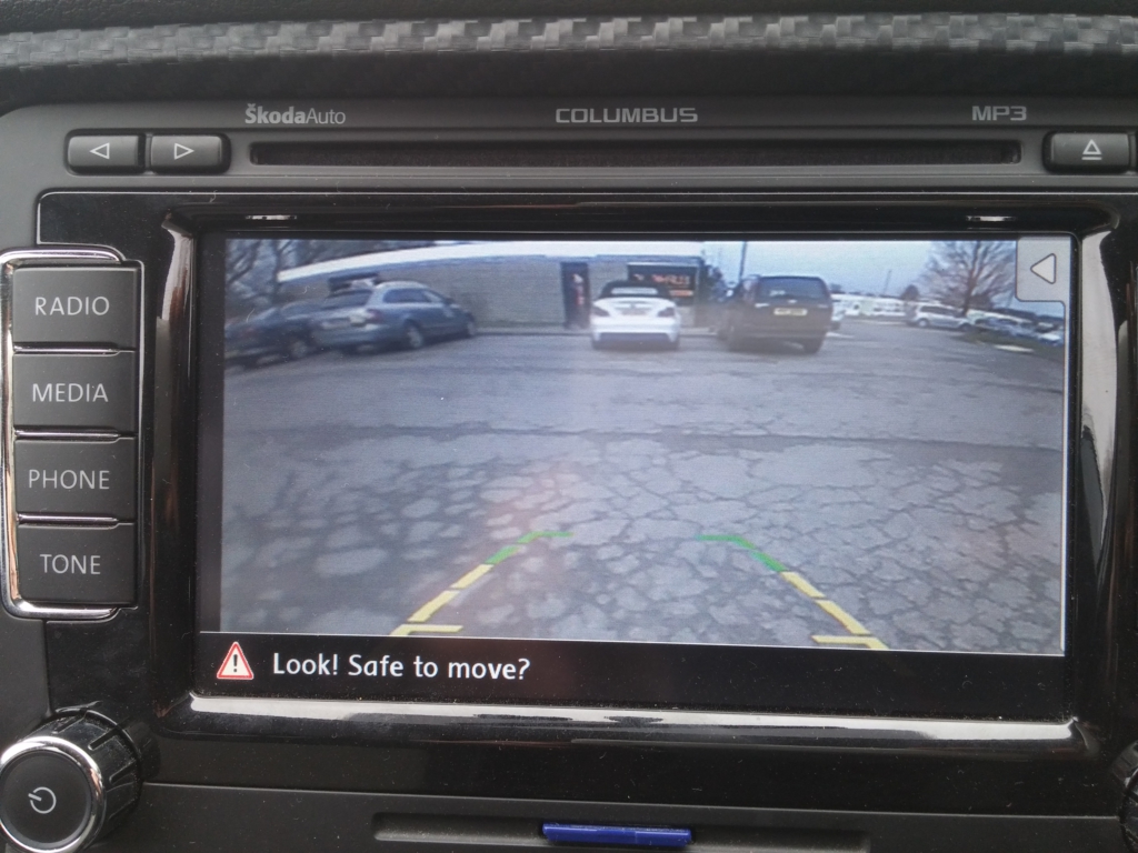

Here is my cheapo camera, not the quality spoken about above but adequate I'd say.
This is the set up I have on mine, with a perfect picture on the Columbus.

Mike thanks for your picture.
I think oem or other camera are similar quality.

And I saw  Red Yellow and green line on Oem camera.İf I buy a normal camera ,Can I see these line?
