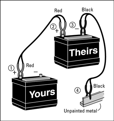

It doesn't quite work like that. If you do it properly no damage should result to anyones vehicle. Best option to jump start someone safely is to wire it like the diagram below shows. On your vehicle use the top front suspension strut bolt or similar earthing point to clamp the neg lead to. Just keep it away from your battery. Only put the positive lead onto your battery. It's safer. Connect everything up before you start your engine. The starter on the non-working vehicle will draw the normal amount of current it needs through it's own battery and then of course, through the leads to your battery. No damage should result at anytime but best to keep your engine running at a very fast tickover so some extra juice is produced for the failed vehicles battery. Just make sure you monitor the jump cables to ensure they don't get too hot if repeated attempts to start are made. Use only good quality cables for the job. A van trying to start may draw more current than a car so heavy duty cables are best. Remember, everyone does this at their own risk.

Yeah...that's mostly likely because you went straight onto your battery with the neg lead. Always keep it away from the battery. But like you George, I prefer the battery booster pack method as like you say, modern cars are getting so complex now. Almost every car is a giant computer and we all know how easy it is to upset them!

In 33 years as a tech and master tech I never once had a vehicle damaged in any way by using the method described in my post. Wino is correct in what he is saying. You cannot crap your electrics if your own vehicle used for the jump has a well charged battery and the engine is running at a smart pace. The alternator will only give the maximum amount of current it was designed to give. Nothing will be damaged!  I've started so many vehicles this way I cannot even begin to recount how many it actually is. Alternators will put out varying amounts of current and many cars will put out up to and sometimes above 130 amps. The main issue I found when I worked in the trade was folks connecting stuff up incorrectly and doing damage that way, or trying to start a very big 24v truck with a 12v car. It just won't turn the sick vehicles engine! Now that's not good! Main message is not to jump start someone if you don't know what you are doing.
