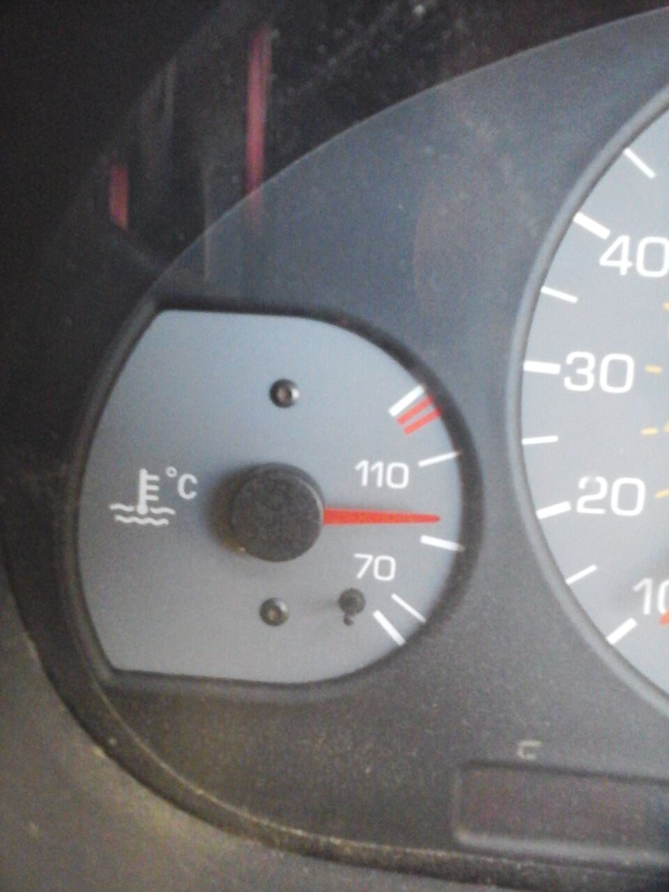

So, new sensor is in, and i did the same test:
Right out of the box the two resistances did not equal. So the original sensor was definitely broken.
let's call the gauge's resistor R1, the ECUs R2.
Startup: outside is about 20Celsius, R1 = 1.5k, R2 = 3.1k
8-9 minutes idle: gauge shows 85ish, thermostate opens, top rad hose gets warm, R1 = 120ohm, R2 = 290ohm
15 minutes idle: fan cuts in, gauge shows 110-ish, R1 = 80ohm, R2 = 170ohm
Engine does not sound any different, and it still osciallates a bit. I guess something else is the culprit.
