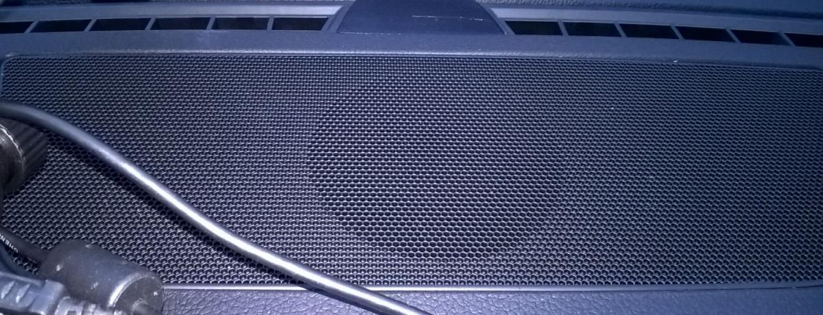

did anyone successfully remove the central speaker mesh cover from the Canton system in Octy 3?
What tools to use / how to un-clip it / does it break easily / how to protect the soft dashboard form damage / ... ?
I'm having some ugly resonance every now and then (mainly in mid range / speech range) and I would like to open it, check for damage / loose parts.
For clarity - please see pics below: one shows the cover as a spare with clips visible, other is the actual one in my car.

Looks like a lot of careful tweaking round the edges with a plastic tool to ease all those lugs out. But though I'm vary happy with my Canton, why did they need a central speaker at all? Many years ago as I( recall there was a stereo bodge in which left = L=(L+R + centre) and right = (R+L + centre) - is that it, or does the centre speaker contribute something else? Anyway, I'm quite happy with the Canton soundstage - infinitely better than the Mk11 which had the tweeters barking in your face because both were angled towards you.
Apaently, the central speaker bounces sound off the inside of the windscreen; read it somewhere but not sure where now.
I would invest in some trim removal tools - e-bay or Aliexpress do some. They will stop or at least limit any trim damage.
Like with most bits of trim, take your time.
Looks like the shorter of the two long sides is the one to come out first, possibly staring at one of the rounded corners, going by the way the clips look lik ethey have shorter hooks that on the long long side.
But it's your call.
I think it will do.  On an old car (Zafira) I upgraded the HU from the CD30 to the CD30 mp3 mainly for the Auxiliary input, but it also had an extra channel for a center speaker. When I fitted that it did make a big difference to the soundstage so I imagine the Canton will be the same.
I have the tools (metal/plastic sets for mobile phones and a plastic set for car trim) and I've tried a bit already. It does not give up easily - thus my question if there is a proven method/tool.
The plastic ones are too thick (the clips are buried pretty deep and there is practically no gap) and the metal ones may give some damage, so I was maybe too careful with them...The grille seems a bit flimsy too, I'm a bit concerned about forcing it :wall:
The odds are you'll break one or two clips - I always do! Downside is it's in an area prone to vibrations, so possibly causing new issues...

have you thought about pulling the head unit to access from underneath? removing the head unit is easy just four euro clips.
A hand to push the lugs out from underneath would be a much safer option even if you are buying a new cover
first 30 secs of this video, unless you have arms like Popeye shouldnt be a problem giving her the reach around.
