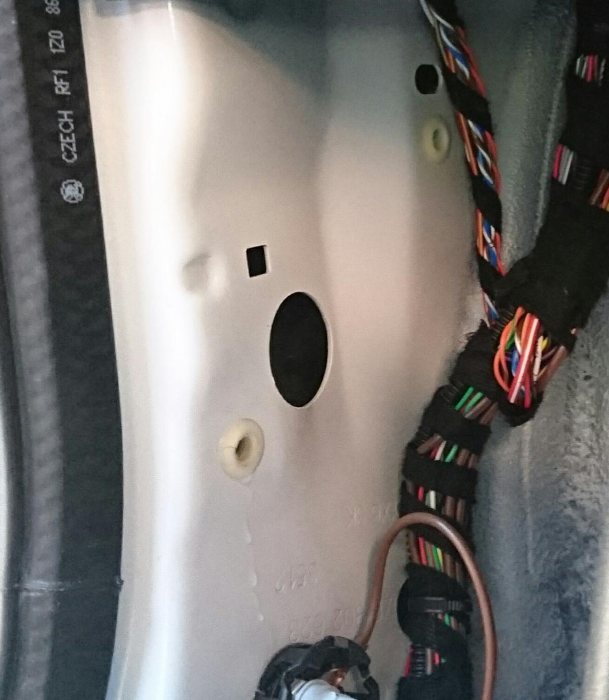

I've actually found where the water is coming in,I poured some water over the left hand side of the winderscreen and I've pulled the plastic trim of the left hand side of the seat that runs up to the glove box.theres aloud of wires running down the side,next to them there is a small hole with a white flange type thing it's only about a centimetre wide,this is where the water is coming out,and there is another hole next to it about an inch and a half wide and it's it full of water.made up I've found it any ideas of what to do next..

These are the two holes where it's leaking..post-62482-0-83310600-1457958579_thumb.jpg
