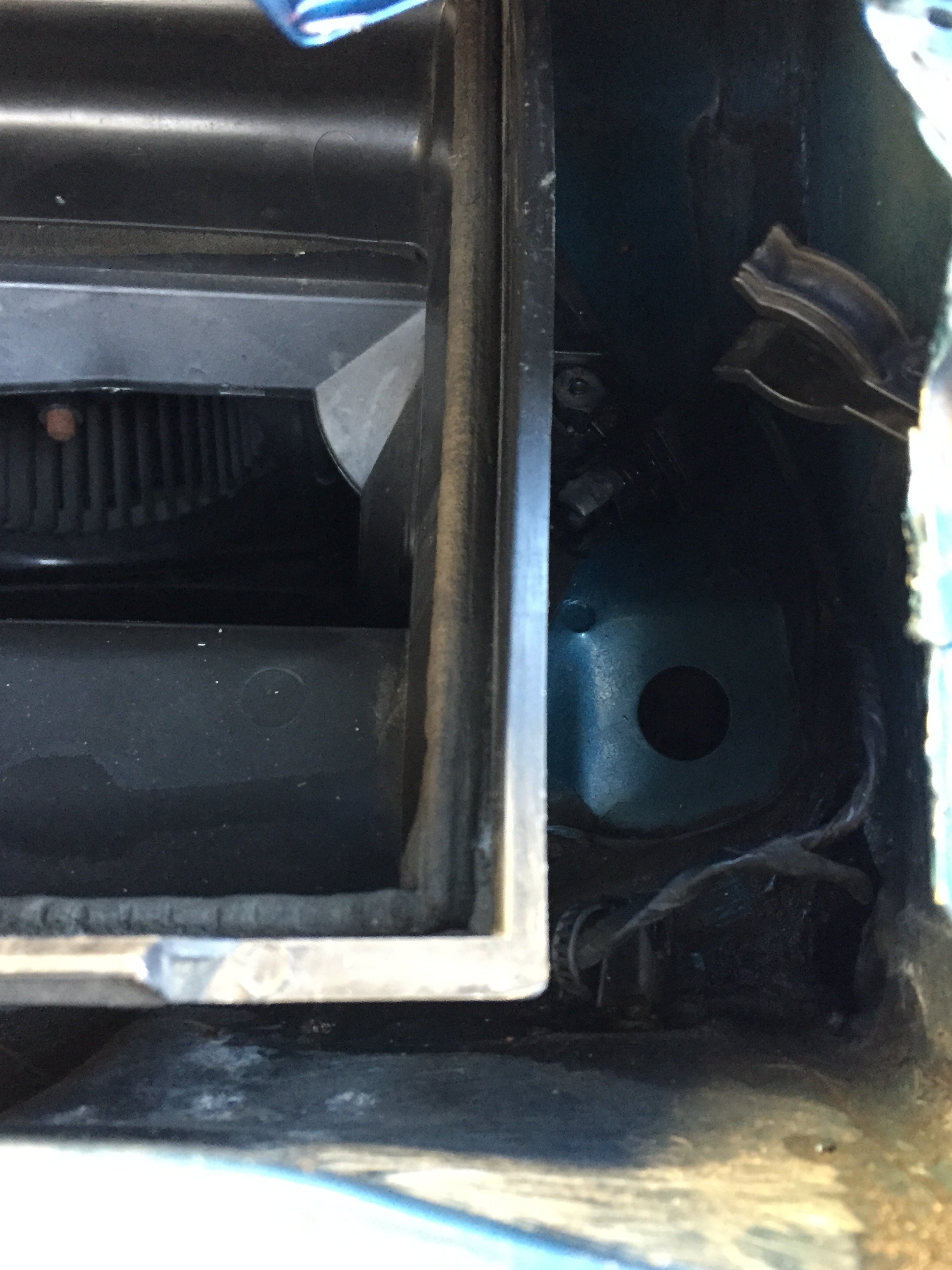

Hi, I have the same issue ie. wet carpet on left side both at front and rear seats. Today I resealed the polen filter house lower edgesbut still have some water  coming in at the most left forward corner of the cabin,under the gloves holder.
Just realized later a round hole outboard the pollen filter house on the bottom of the through - made by Skoda/VW - that is open to cabin where the leakage noticed.
(the opening in the side wall is open leading to the front wheel for drainage).
Any idea what is the purpose of this nice round hole in the through before the windscreen, next to the pollen filter house ?

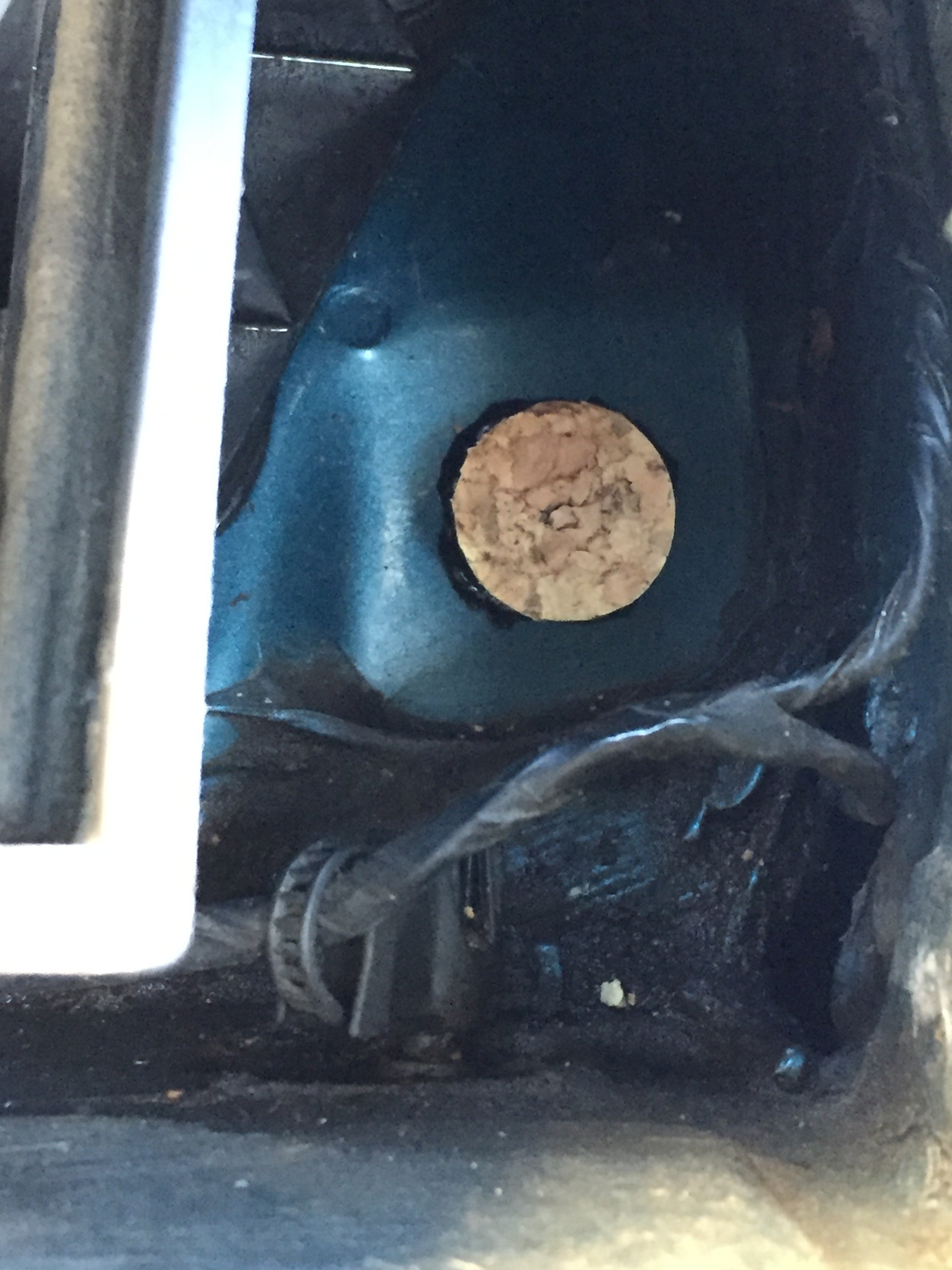

I plan to close it with a rubber plug or similar, but still no idea what is the purpose of it ? Why it is open ? Not found any plug or cover around.
Thanks.
Please find attached the photos of the mentioned hole, before and after plugged.
  • 7 months later...
From that time no more wet carpet, everything dried out.
