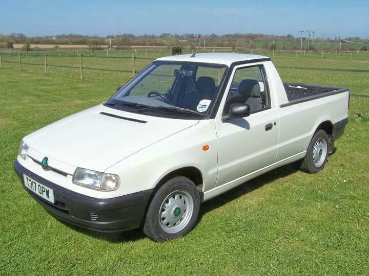

There are no pictures of the first truck but here are the other 3 in their finished forms:

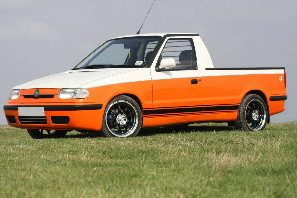

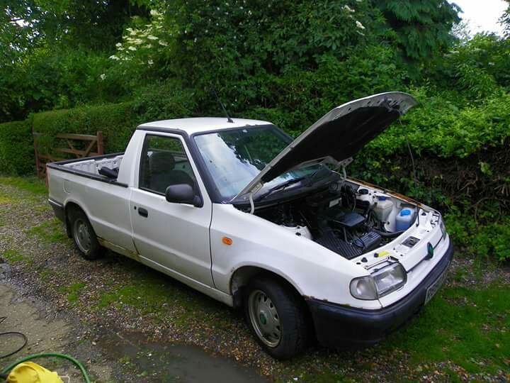

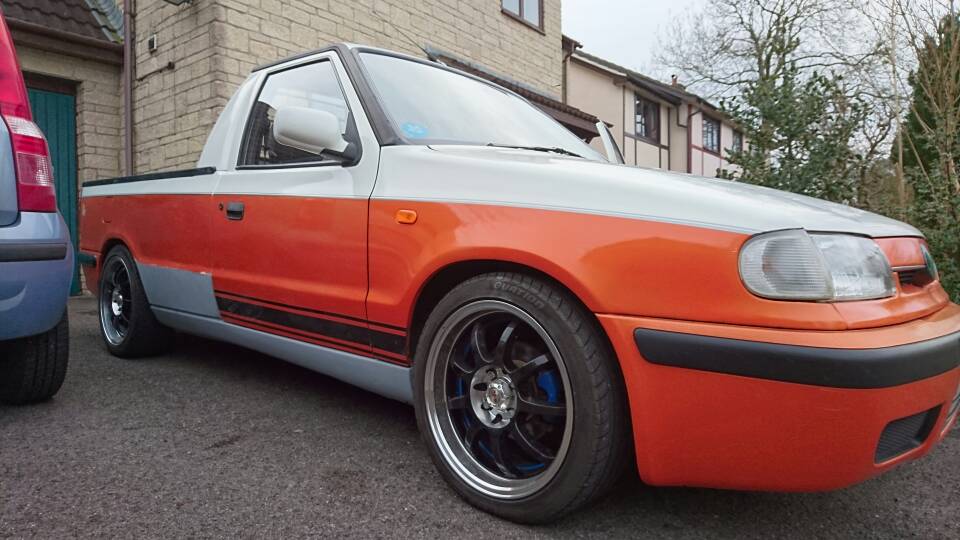

On to the restoration of this one. Here is it as it began, pretty good nick due to the lowish mileage (70k ish at this point) and local miles. The standard rust patches are visibly coming through.

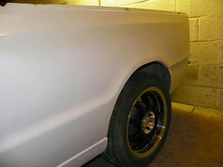

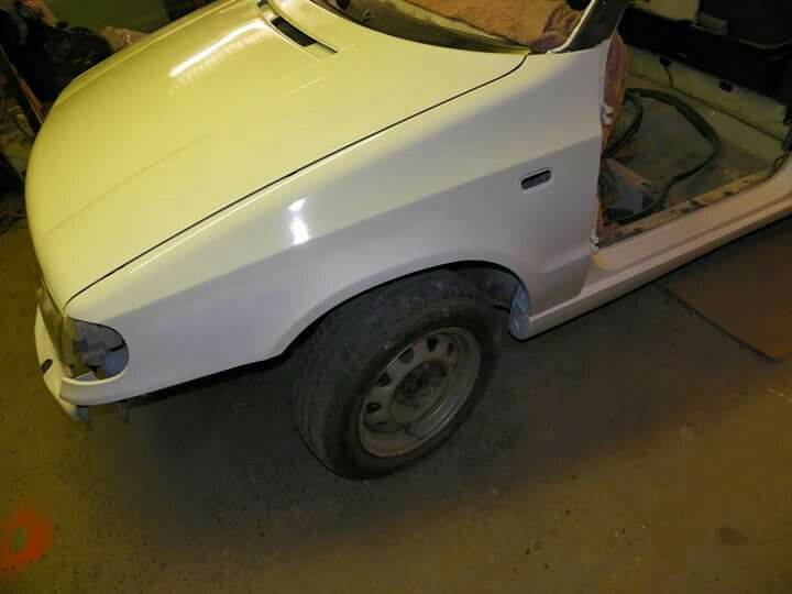

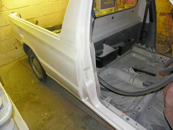

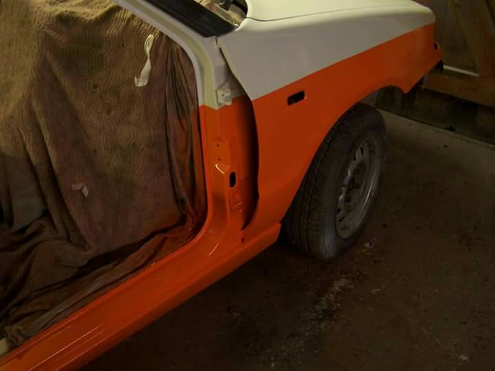

Then Don stripped it down and began replacing/repairing all rust and stripping it down ready for painting.
New front wings were put on, the sills repaired, the load bed repaired and new sheets of metal.put in in places and the inner rear wings rebuilt.
Then it was sprayed in Citroën alpine white over the original white and a bright orange for bottom half.

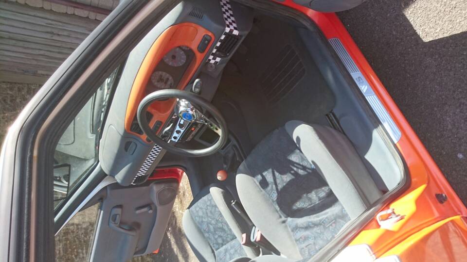

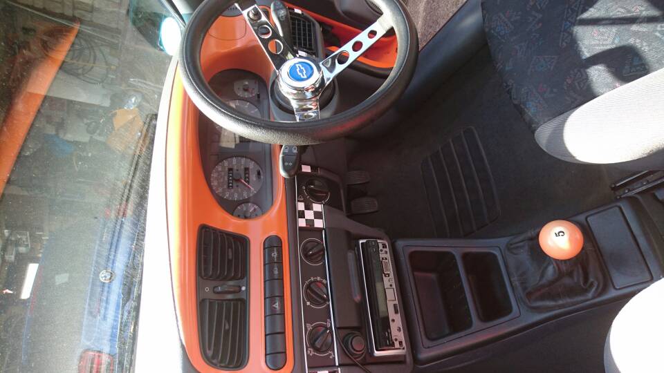

Cosmetics:
Wheels 7"x16" Deep Dish

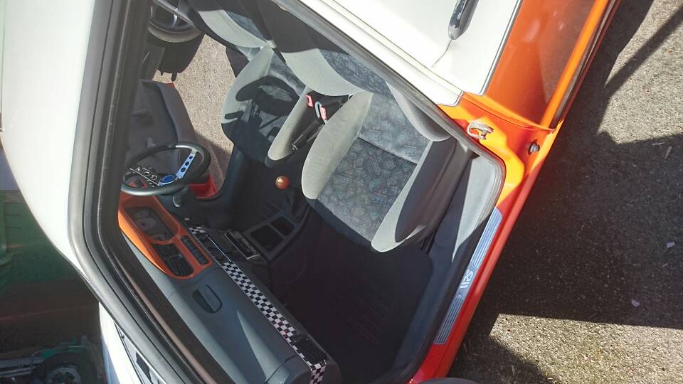

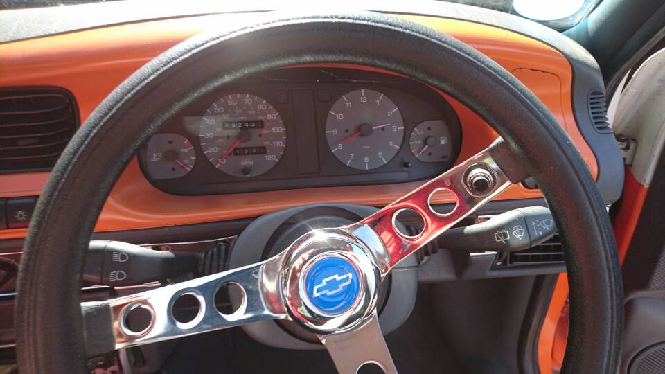

American "Grant Deep Dish" steering wheel
JVC CD/Radio.
195x45x16" Ovation Load Rated Tyres
45mm Lower Springs.
Rear wheels spaced by 20mm
Dash Surround painted in Body Colour
Gearlever shortened and a No 5 Pool Ball fitted
New Colour matched Floor Mats
Stripe black Graphics down sides and across tailgate
Silver reflective tape on rear window which flashes different colours depending on light
Front bumper is a facelift Felicia version
Both bumpers Colour coded
Door Mirrors colour coded
Graphite grey Rear window surround
Graphite great Tailgate plastic strip
Load bed Grey Anti-slip coating

It wasn't too long before I had a radiator leak, possibly that long journey on what looked like quite an old radiator.
A whole new radiator was ordered and replaced by myself along with renewing all jubilee clips.

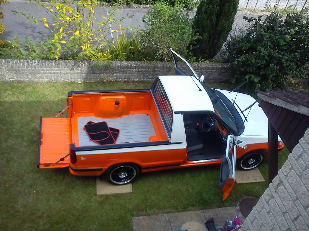

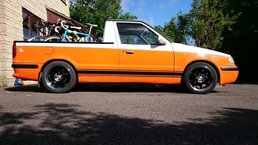

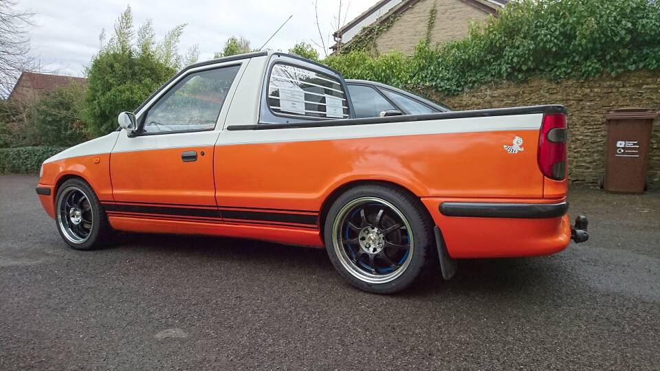

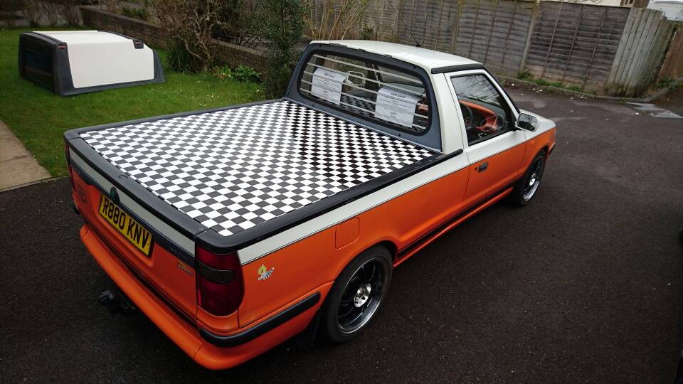

I bought a truckman top to keep stuff dry in the winter, it's honestly the most useful thing I could have bought for this truck. Locks too so stuff is secure.
Also load bed great for two bicycles (fit under truckman too)

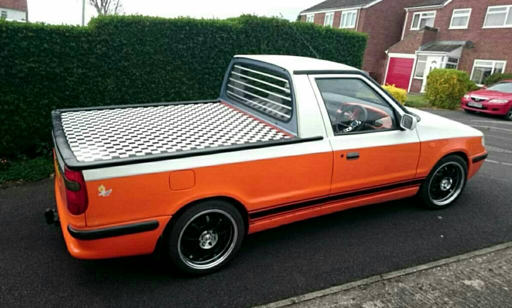

And summer board set up was cleaned up, given a second coat of white emulsion and then vinyl wrapped by myself, not perfectly flat in.places as was first attempt but looks awesome!
I will continue with more photos and other mods/replacement parts/work/servicing that has been carried out another day. Hope you enjoy :)

The truck came with a Kenwood stereo, but being a 16yr old lad at the time that was straight out replaced with a flip out 7" screen Pioneer bargain I found on ebay - it would have retailed when new at almost £1000!
I then bought some Alpine 13.5cm CoAxials speakers to replace the originals and trul the difference was unbelievable, the clarity of the sound and new depth of bass was incredible, would highly recommend anyone with a Felica buys a set if they haven't already! I had plans to rig my phone up through the AV input to play its satnav on the screen, but I am still struggling with the digital to analogue conversion hurdle!
(Grainy scolling image on screen as was probably messing with the AV input when i took the photo)

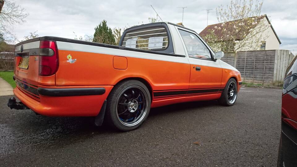

Update on photos, as it currently is.
All painted, sticker section replaced.
Windscreen leak fixed, interior all in (I had the carpets out for about 6 months so they weren't damaged whilst I fixed the leak)
