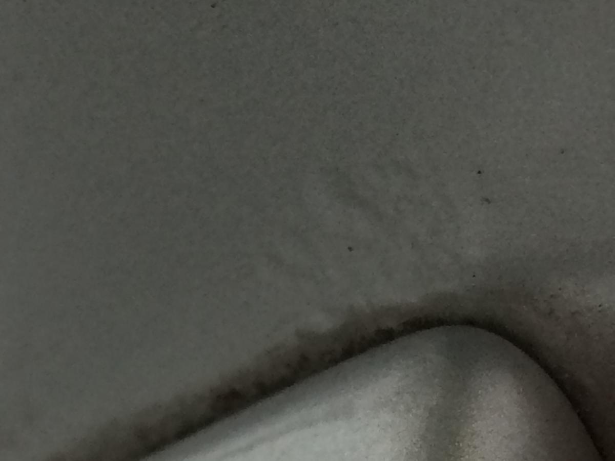

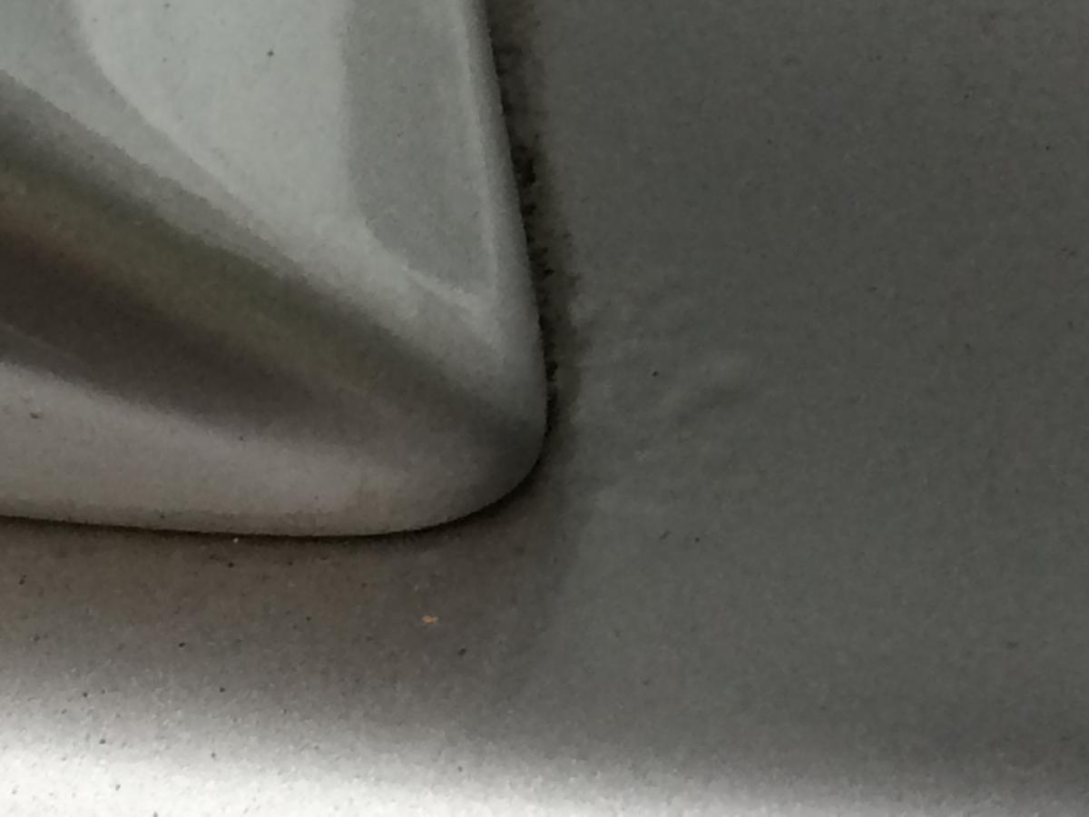

Had my car at the dealers on Tuesday as have rust bubbles under the spoiler and had pics taken and sent down south, paint is not broken so to me looks to be rusting from inside out. Got a call today to say skoda don't think this is a manufacturing fault, the man that's dealing with the claim said if I want to dispute this I need to get an independent check organised by them and if found in my favour will be done under warranty, if found in their favour I have to pay the £180 fee. Wonderful how many people have had the "independent check" and how it went, if there's many who had it found in their favour? Cheers

To me it definitely looks to be coming up from under the paint. I would guess at some exposed metal where the spoiler has been fitted.
I noticed the same on my 58 plate vrs when i removed the spoiler for repainting due to laquer peel & i showed it to the bodyshop who were painting the spoiler for me & they thought it was due to water getting in under the spoiler where it mounts to the tailgate so i touched it up  & its got no worse over the last 2 years,i have small rust marks appearing on the sills at the front & i have a small patch of rust appearing on the bottom edge of the tailgate.  :thumbdown:
I have just taken my spoiler off to repair a small chip in the paint. Really annoyed at my self, as I was the one that chipped it!! Anyway, I noticed some very small bubbling of the paint underneath the spoiler. Seems it must be a common fault.
