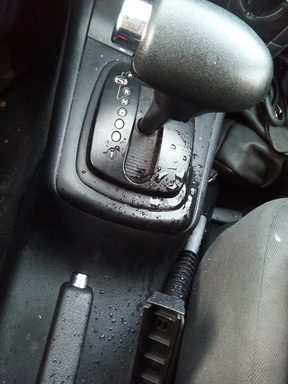

when there is raining there start to drip water from the roof carpet that´s under the lights wich are above the front window
and it drips on the manual shifting.

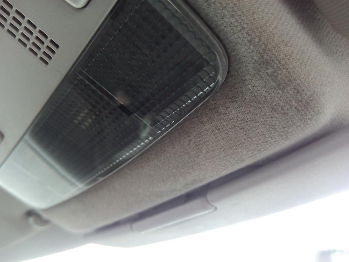

Got a picture of it behind the light?
the water flows while it is parked, I´ll try to send pictures today

here are some pics

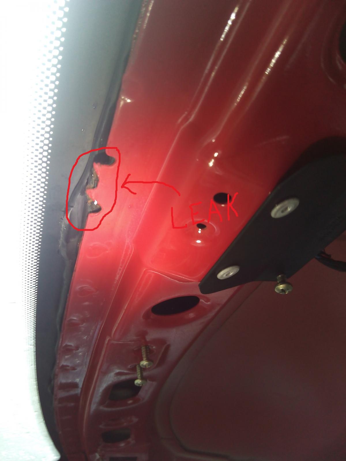

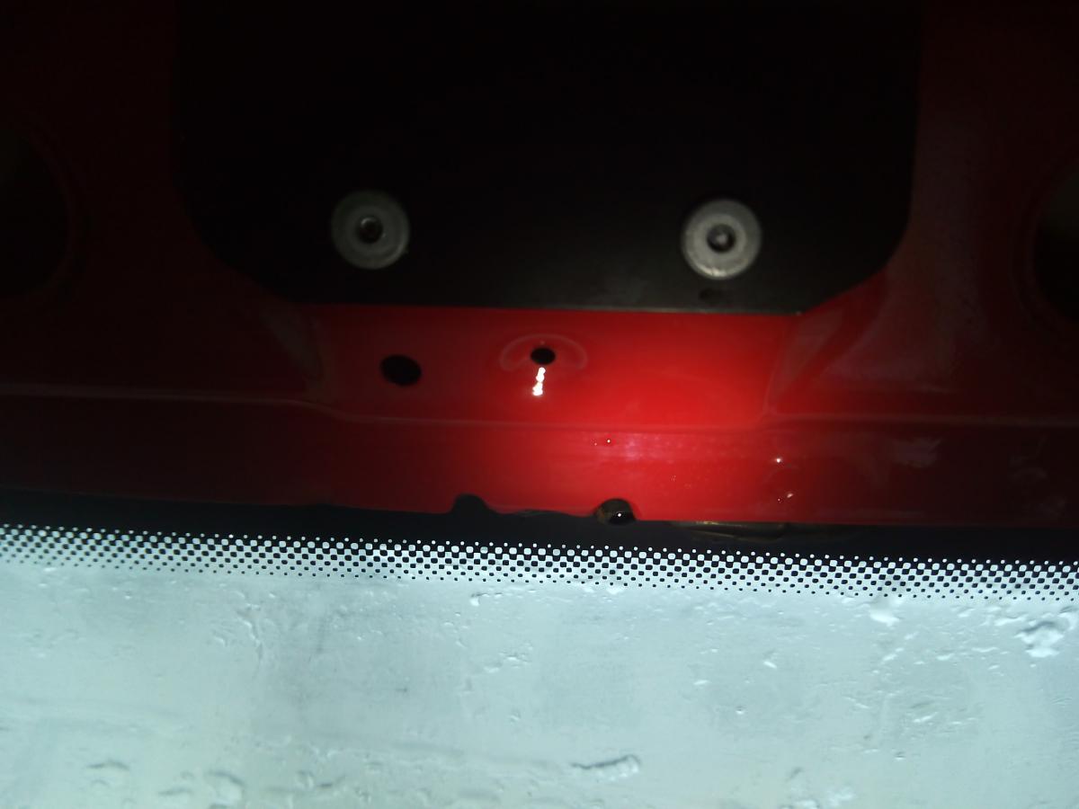

I think I found the problem
after I removed the headlining
I see it is leaking from the sealant that´s used to seal off the frontal windscreen
Can I use some kind of a black sealant to seal the screen on the outside?
here are pics of where the leak is coming from

Well you can try. After all, you can't make it worse.
Failing that get a windscreen company to remove and refit the screen?

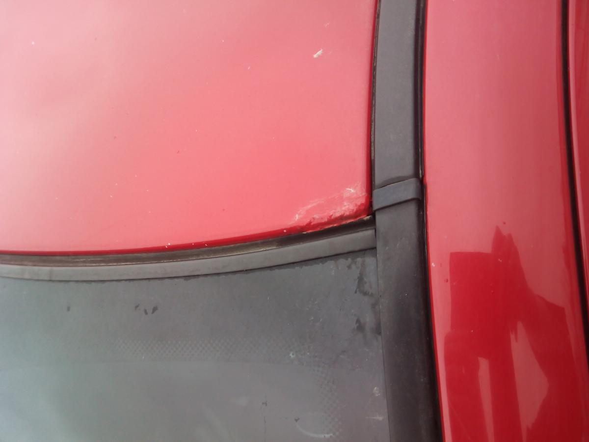

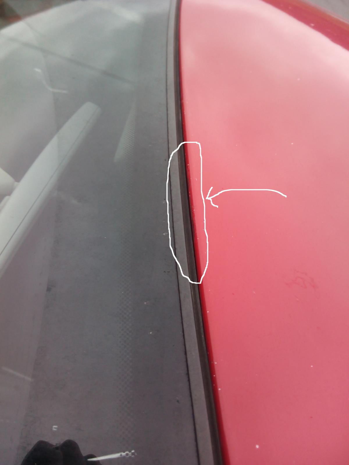

I think the problem is there on the pic
there is a small gap between the roof and the black rubber
I would take it to a windscreen place like suggested above and they will be able to tell you instantly if that's the issue and be able to remove and refit the windscreen properly. Sealant could look a bit messy and in such an exposed part of car bonding on 2 different materials, may not work well. If you using sealant on a buget, try use something like gutter sealant designed for outdoors and flexibility.
