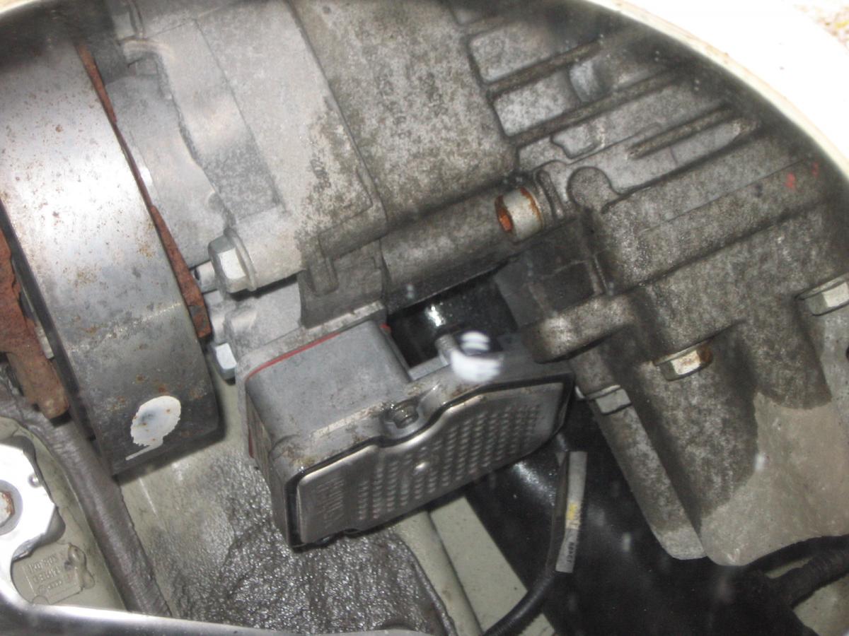

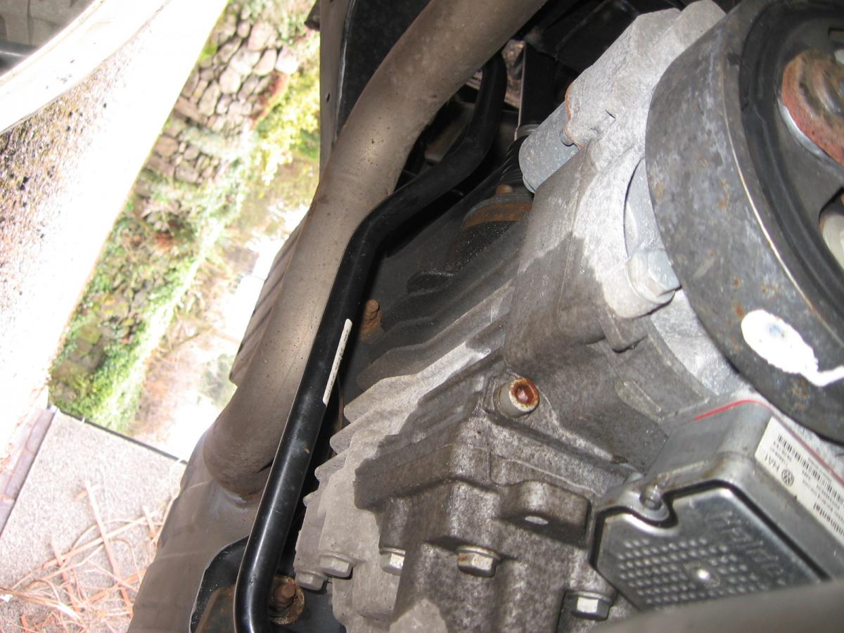

Well I have been under the car and its a generation 2 haldex control unit you can see which one it is in the link go to autofaultfind  on posting #24. it is mounted on the backaxle on the nearside ( passenger side) so I drove the rear nearside wheel up a ramp and handbrake on, in gear and wheel chocks.
The unit did'nt look to bad no sign of corrosion on the cover and the seal around the unit appeared to be okay.

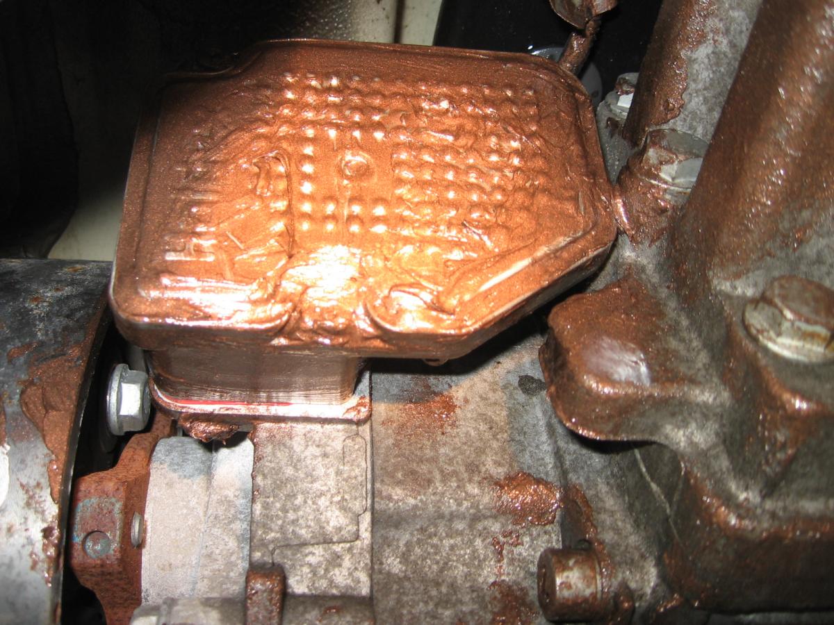

So I have sealed around the depression of the lid to the body of the unit with copper ease and also put a film of copper ease over the lid, so thats about the best I could do with the position of the unit it's not too bad to reach on your back!! up a garage ramp would be a doddle.

I have put 3 pictures on the posting just to show before and after  one picture was taken via a mirror under the car so things look the wrong way round!!
Please click on the pictures to make them bigger I'm still learning about all this so excuse mistakes !! The damp area on the rear diff is anti corrosion spray before i put the copper ease on the unit.
