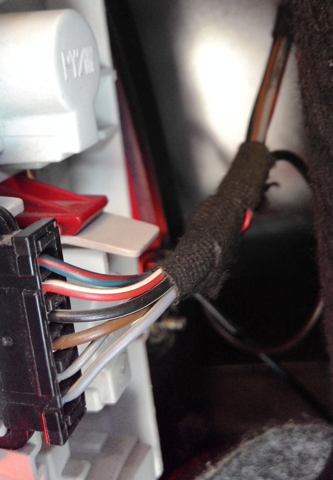

Hello, does anyone know how to wire parking sensors?
Car didnt have OEM parking sensor.
From parking sensors they are coming two wires: black and red.
This is picture of back of rear left light.
Attention: Car have rear parking camera..
Can someone help me? Tnx

Well lets try one more time, if anyone know wich wire are for reverse, pls help..

Don't suppose you have a multimeter/ electrical test, or one you can borrow?
Do the aftermarket sensors you've brought require it's own power feed, or is it simply meant to piggy back the rear light power activation?
I think not...Aftermarket sensors come up with just two wire:
red and black....I suppose one of them is ground and other one need to be connected with rear light.
I connected the black to ground and soldered the red one to the metal strip running to the reverse light bulb on the bulb holder.  Worked fine for me.
Gaz
Black will be earth.
Red will need to go to the rear light.
Pull out the light unit and follow the tracks to the correct bulb. (ie put it in reverse and see which bulb lights).
There will be two tracks, an earth track and a postie track.
Personally I would put an inline fuse on the positive wire of the unit - incase things go wrong. Better a fuse blow then your car goes up in flames. (In fact this is essential).
