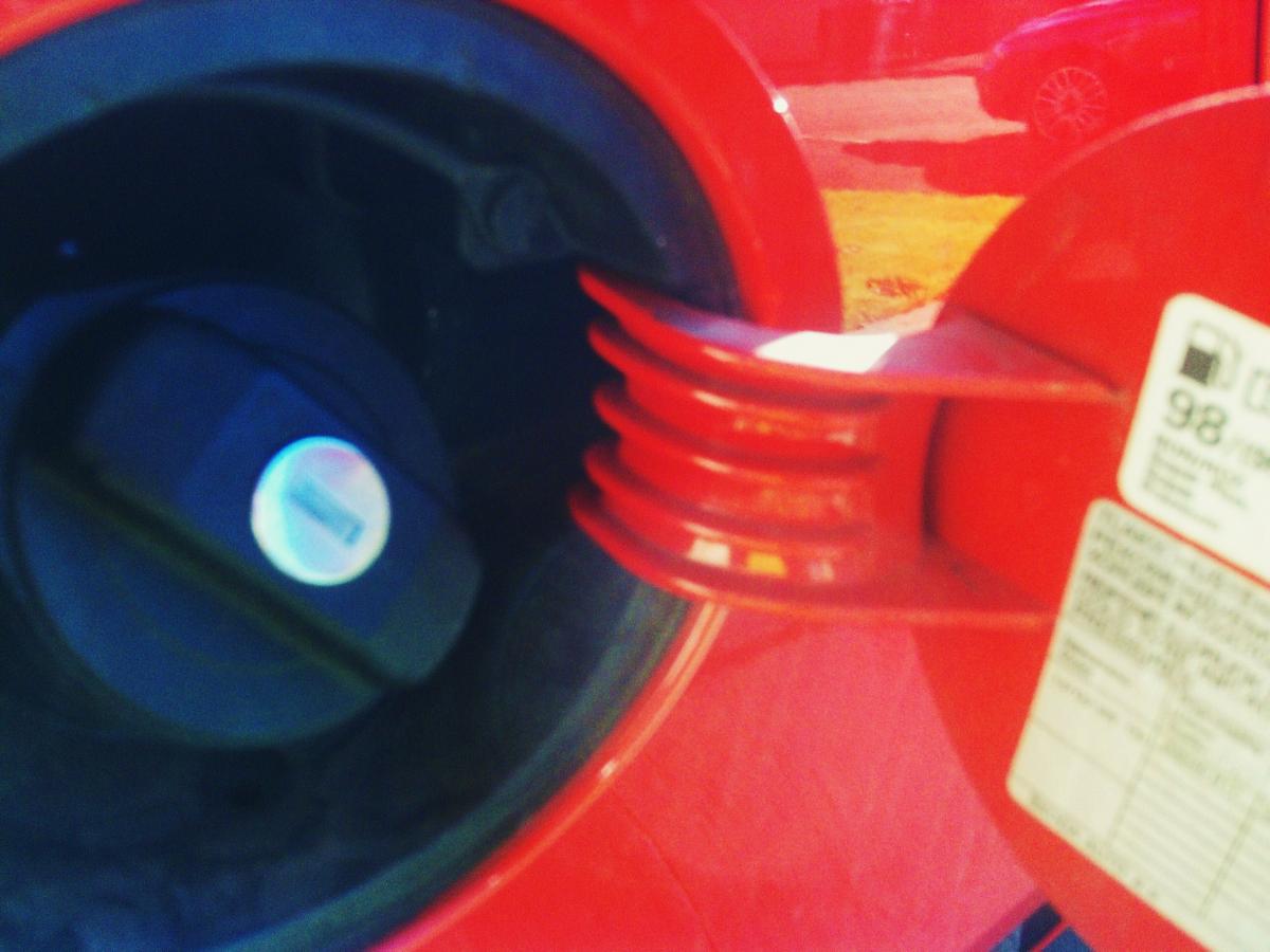

"why do Skoda put '98 Super (95)' on the filler cap lid of a 1.4 TSI / TFSI 132-136 kW Twincharger.?" I would guess because the recommended fuel is 98 RON but to confirm that it will run perfectly well on 95 to 98 RON?
"98-100 ron widely available on Mainland Europe" - my emphasis.
As I said earlier - the vRS is designed to run on fuel from 95 RON (widely available) up to 98 RON. Running it on 102 RON may do it no harm, running it on 97 RON (frequently available but not as frequently as 95 RON) certainly will not.

Not rocket science, & not rocket fuel, just the recommended fuel by the manufacturers on the Filler Cap Flap
of a Mk2 Fabia vRS Twincharger. *Super 98* (95)... 95 being the minimum and safe to use, obviously.
