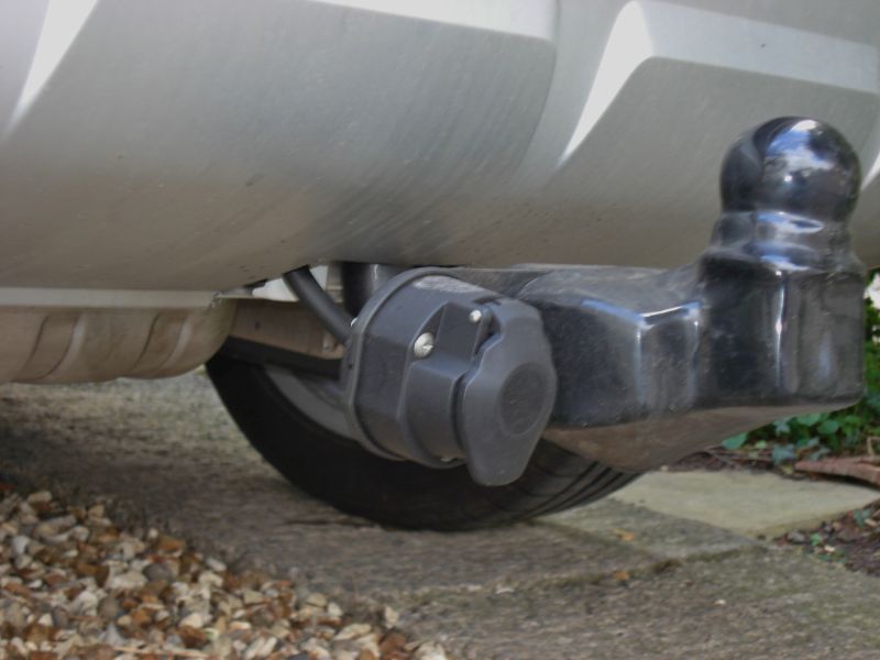

I have a Westfallia fixed fitted, supplied by p f jones complete with loom etc fitted at my place in uk by their recommended fitter, ok accept its permanent but I cut a 50 x 50mm square out of the silver lower panel left off by the fitter, i then refitted the panel, I can get pics if reqd!

Can you get a photo of that and send it to me?
Looking at options for the new one.
I took a photo of my tow bar, for a neighbour, so I will post it here.
