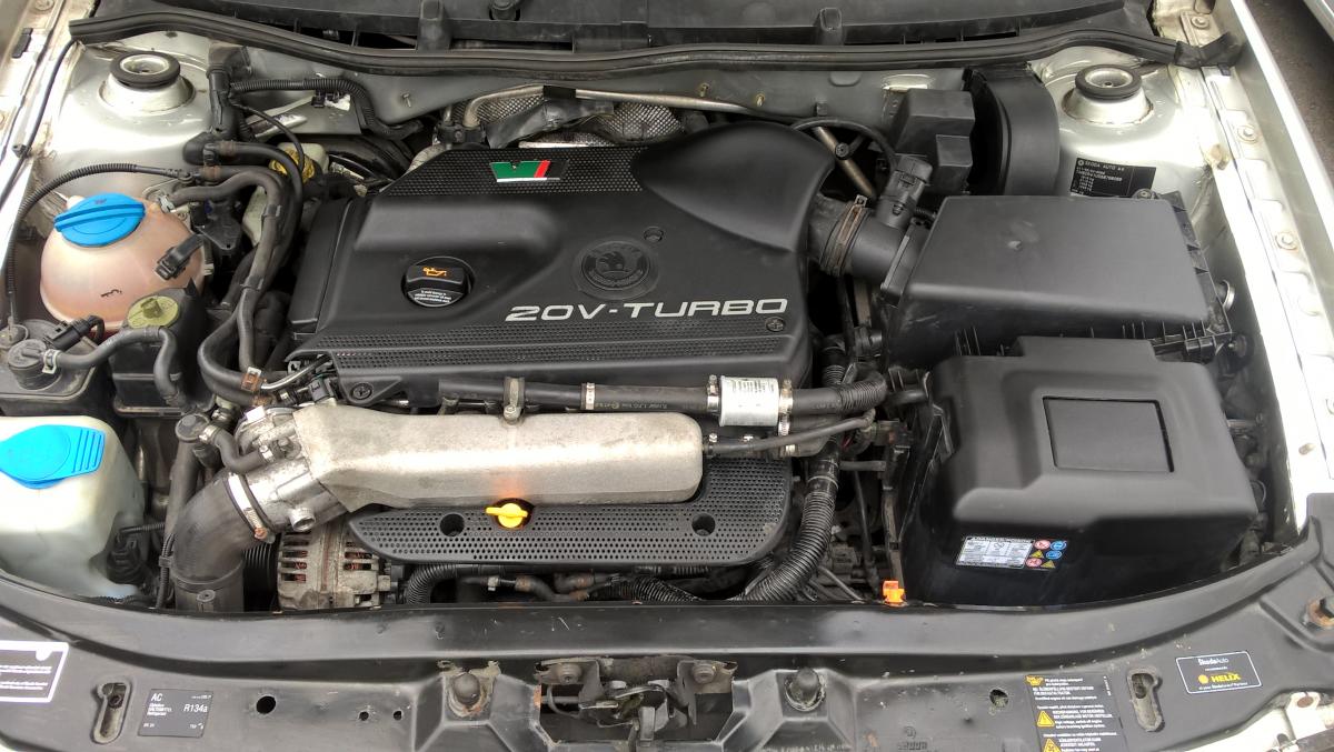

Engine cleaned with some cheap Astonish engine degreaser - good stuff for £1.50 a bottle

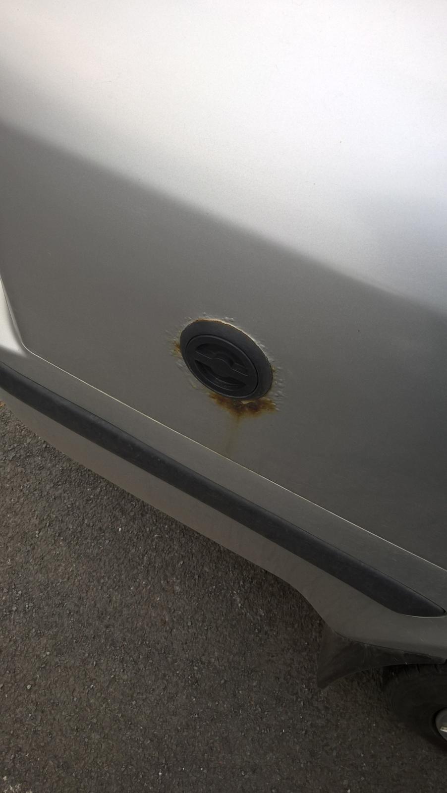

and this Is the worst of the rusty bits

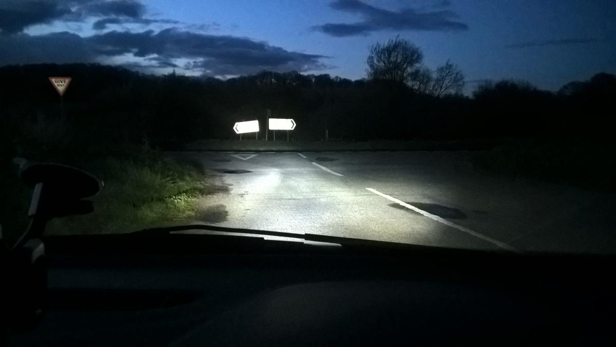

For those that are interested - this is the light output from the H4 LED bulbs
How does the beam pattern look with the LED's?
I tried some in my Mk3 Mondeo but the beam was scattered all over the place.
Since found they are good in projector lenses as the lens directs the beam where it needs to be but utter carp in halogens due to the light bouncing off the reflector in different directions.
I've got some projector lenses to fit in my headlights, so I can fit the LED bulb kit.
Beam pattern is spot on, went through the MOT fine as well, did need the aim adjusting slightly though.
