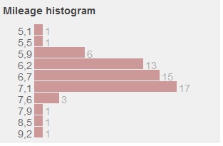

Few months ago, I've made some research based on Spritmonitor data.
On the Ford Focus 1.0 125 Ecoboost, the average fuel consumption in real life was 43% higher than the manufacturer figures, based on a population of 184 users.
It was only 18% higher (than the manufacturer figures) for the Octavia 1.2 TSI 105 (79 users), 24% higher for the Octavia 1.4 TSI 140 (113 users) and also 24% higher for the Golf 7 1.2 TSI 85 (123 users).
The actual average consumption was higher for the Ford (6.72l/100km) than for the Octavia 1.4 TSI 140 (6.59l/100km). Manufacturer figures being respectively 4.7 and 5.3.
So, if the new 1.0 is a pleasant, less heavy and still as powerful engine, it might have an interest over the 1.2.
But I wouldn't bet one instant on a better fuel economy...
