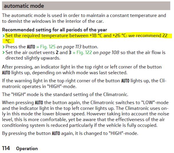

The climate control regulates between the set temperatures of 18-26 degrees. If you rapidly want to cool the car then select the blue section below 18 degrees and the car provides unregulated cold air to cool the car. Similarly if you select the read section above 26 decrees you get unregulated heat. If when selected to 18 your car isn't cool then there is something wrong. In all the climate controlled cars I've had, I have left the temp set at 20/21 degrees all year round.
I'm pretty sure if you just turn the dial back from "blue" to "18" it will just revert back to auto at 18 degrees..... Just pressing the auto button instead reverts the system back to it's default of 22 degrees.

There are two Auto modes on the climate control - if you press Auto a second time a different LED lights up on the Auto button, which puts the system in a more aggressive cooling mode, presumably at the expense of economy. I only use it on very hot days, so it hasn't been used since 2014.

With regard the two auto modes yes the left hand auto LED is slow fan mode where the fans never go above around 50% and the right hand LED means it will use the fans up to 100% if required. This works when both trying to cool the car or heat the car up. I can't see this being an issue on economy as it is only the maximum fan speed that is changed I believe.

Knew I had read it in the manual... "We recommend 22 degrees"
