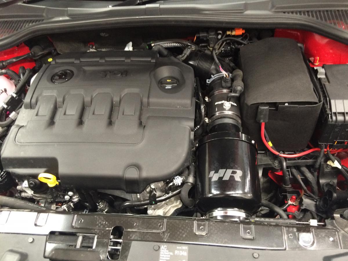

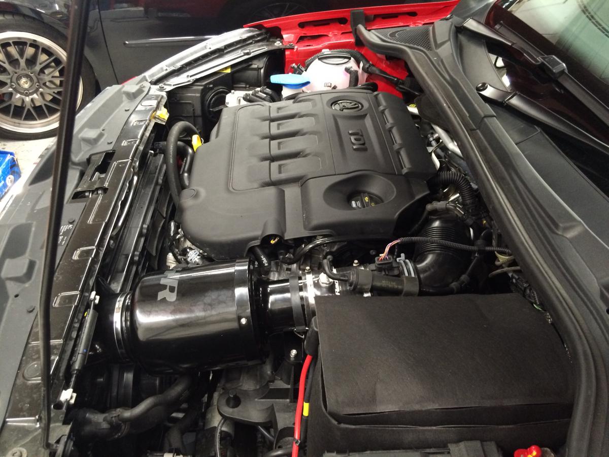

I am going to fit a Volkswagen racing panel just because it will turn out cheaper in the long run due to the high mileage I do
