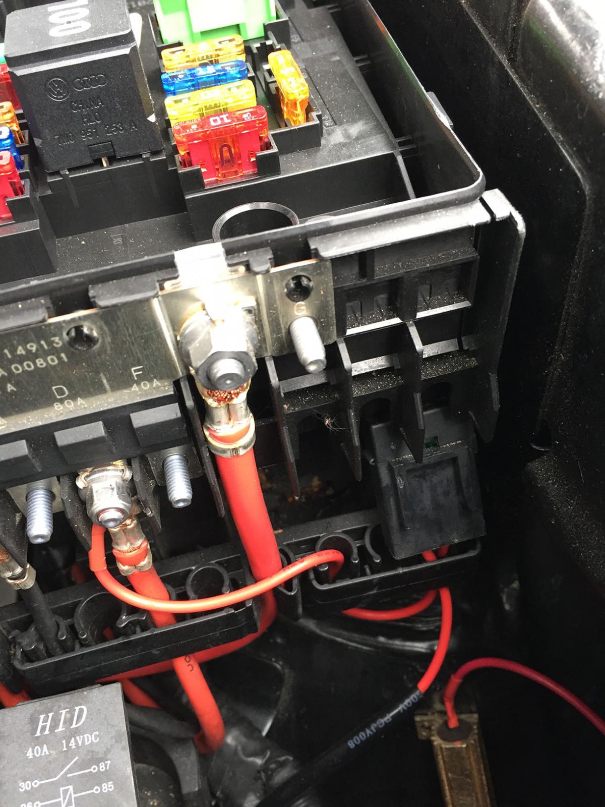

As I'm in the process of building a complete wiring loom, fuse and relay box, etc. for my MGB GT restoration, it occurred to me to use a relay to trigger the HID kit on the Skoda.
A quick search on eBay turned up this pre-made loom: http://www.ebay.co.uk/itm/261048165322

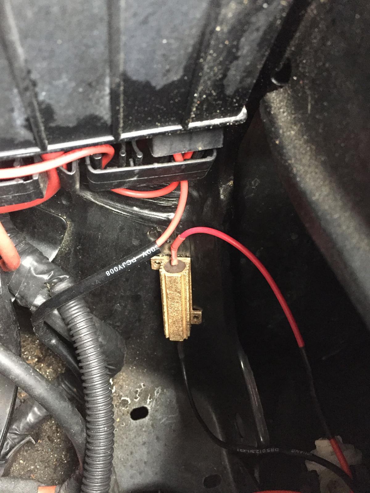

A bit of extra modification was required to extend the earth to reach the driver's side earthing point behind the headlight. To trigger the relay, I tapped the headlight wiring harness, plus I added 50W 6ohm resistors across the original wiring so the BCM doesn't flag the bulb-out notification.

Using a relay and resistors means the BCM only ever sees the resistor and assumes it's a halogen bulb. The HID circuit is then independent from the car's main loom & fused accordingly. I've had it fitted for a month or so now & using the car daily without issues.

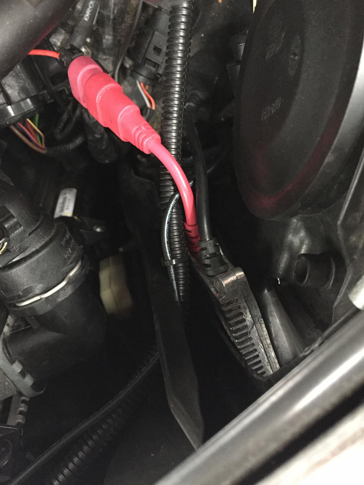

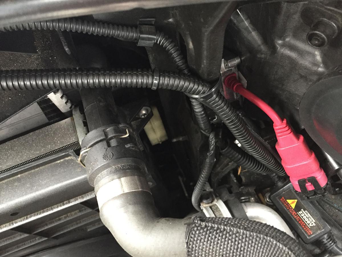

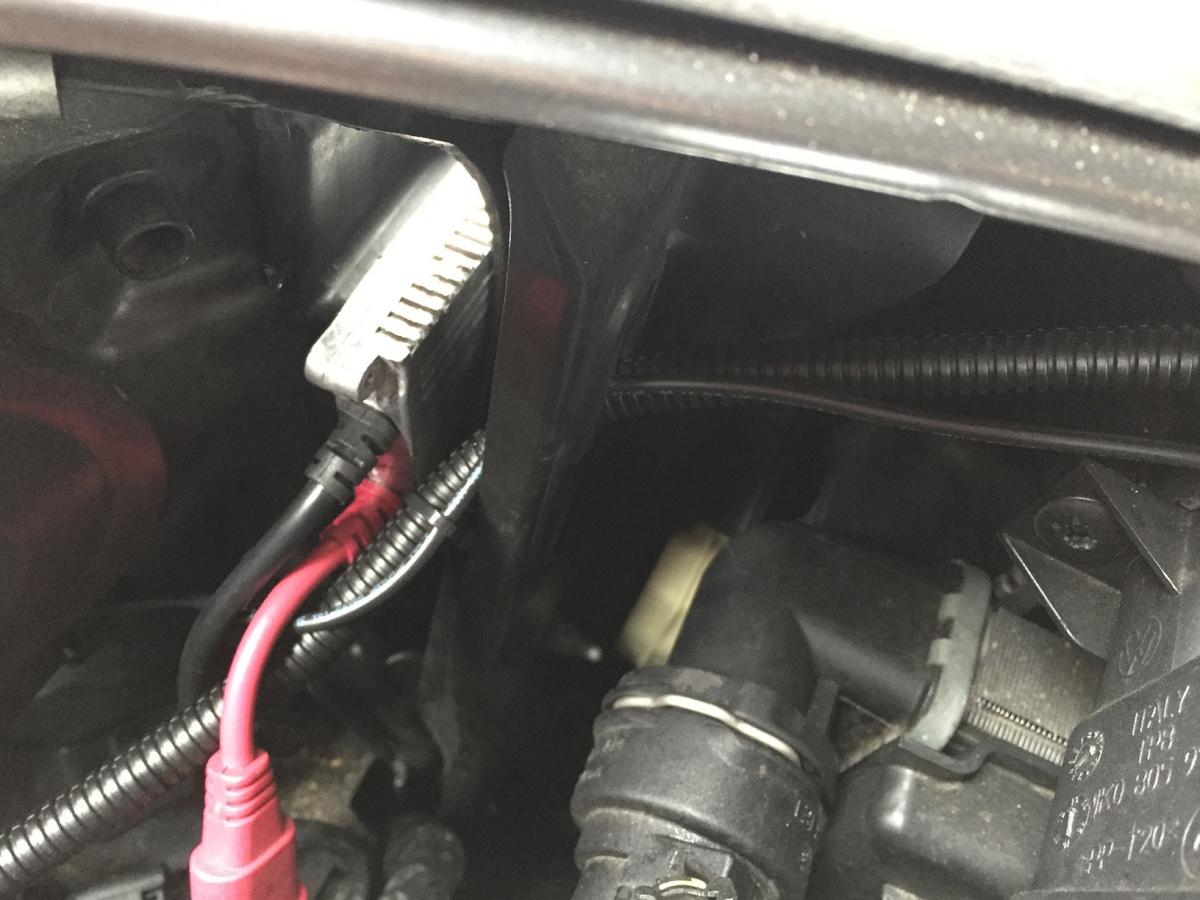

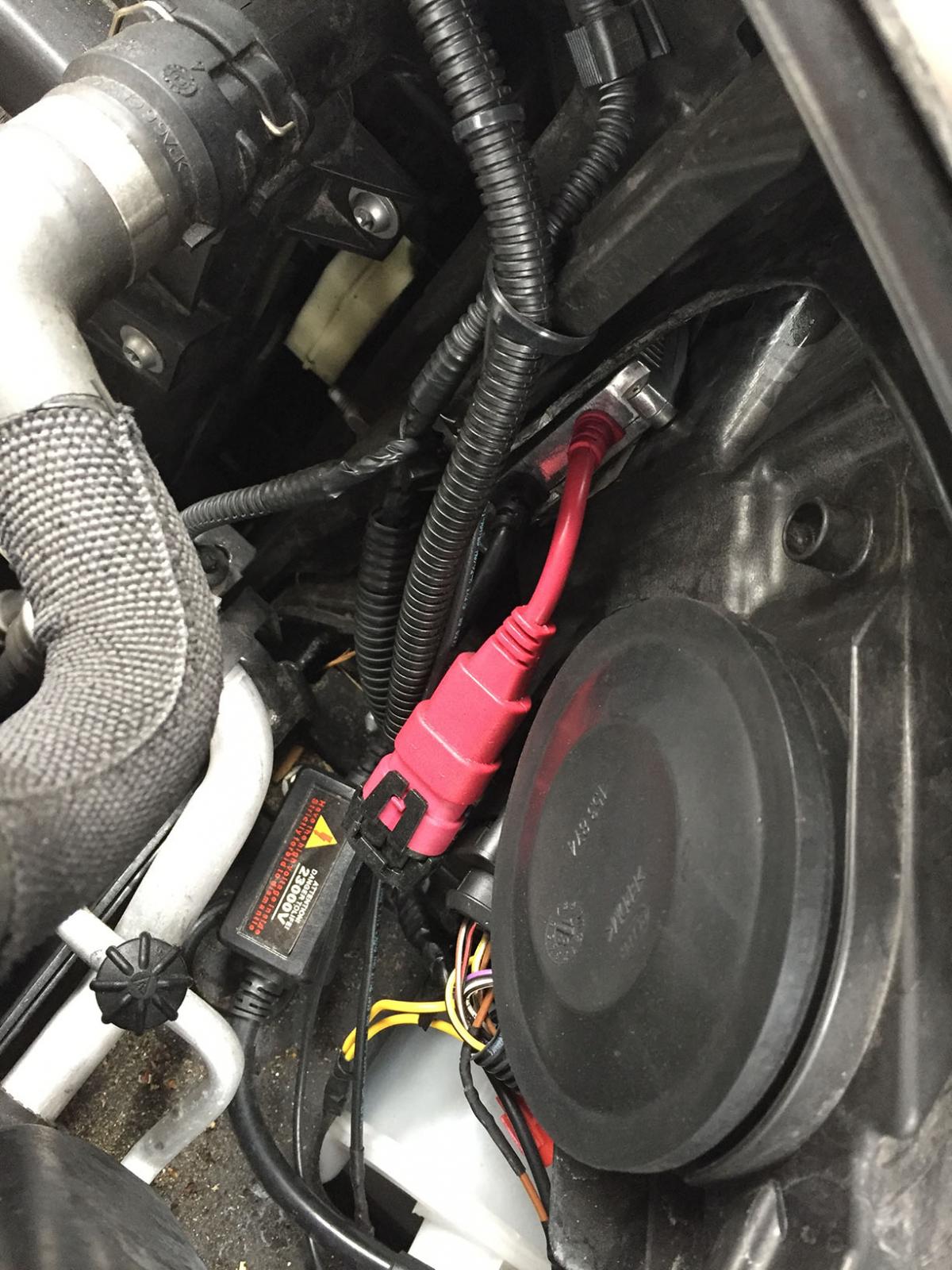

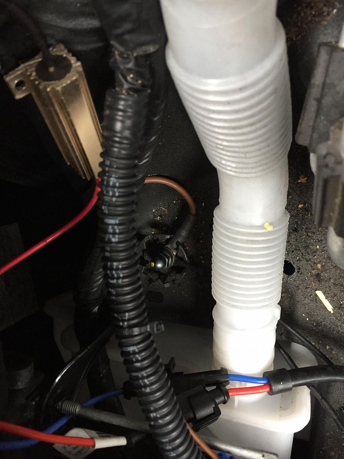

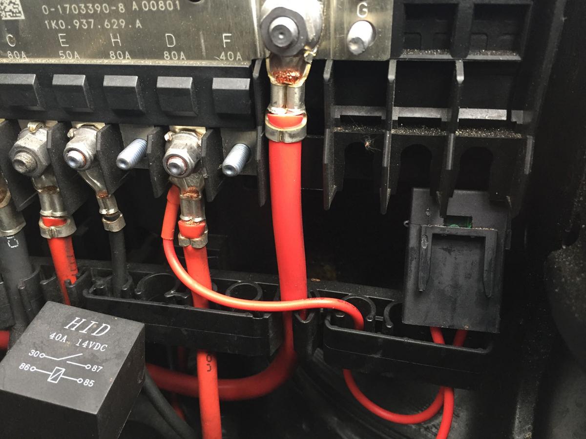

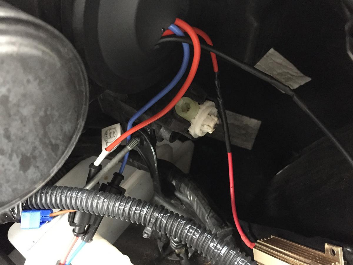

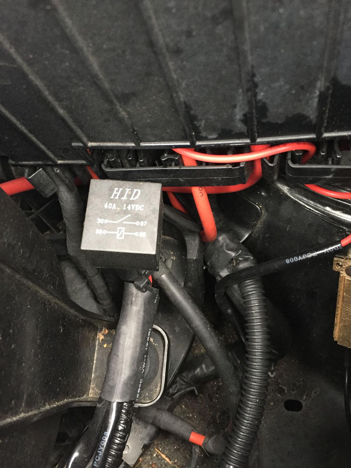

The way I hooked everything up has been trouble free for around 8 months now. Here are some photos for reference...
The ballasts are tucked in either side of the grill, with everything else routed (relatively) neatly and secured with cable ties. The earth is the capped nut under the washer bottle filler neck, so I extended the cable to use that as I wanted to use an existing earthing point. I guess I could have earthed from the fuse box, thinking about it.
