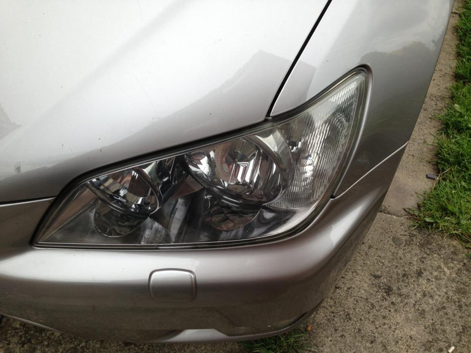

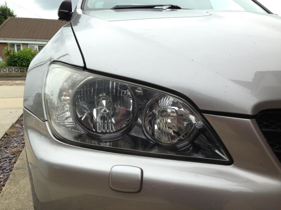

It's not a necessity to have projectors with xenons though. There are plenty of factory fitted xenon cars that have still had reflector headlights.... Honda Civic, Early Mini Cooper S, Nissan 4x4 who's name escapes me, some Volvo models and my own previous Lexus IS300 are just the ones that spring readily to mind. The issue is that when used with reflector headlights the bulbs have to have shrouds fitted to stop the light shining into the lower area of the reflector.
Attached are pics of the ones on my old IS300.... When the headlights were on the bottom third or so of the reflector was totally unlit.

These are designed to work in reflector headlights though.
