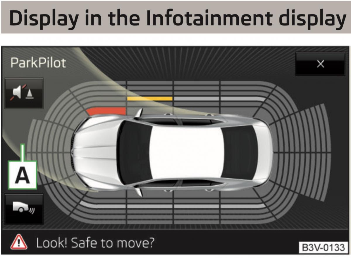

Driving into my (very narrow and carefully watching the granite walls either side) driveway I heard a whistling sound which came from the region of the Columbus.  I applied the brakes and looked at the Columbus in time to see a picture of the car (in plan view) surrounded front and both sides in three red signs headlined WARNING then with a couple of lines about the warning, the information was the same on all three sides and only stayed visible for a split second, not long enough to take it in.  Never appeared before or since no other icons were on the screen, I've done a couple of hundred miles and driven into my driveway in the same manner many times since.

I should think it was this, it lit up on my display in red when a car braked sharply in front of me and turned left, obviously it believed we were about to have an accident, would imagine it thought the same turning into your very narrow drive, perhaps a little quicker than usual or a little nearer one of the walls.  The picture is in black and white but was red on my dash.

Like this?

Yes have seen this a couple of times when the car in front has braked hard and then turned.
It also works with low flying fat wood pigeons flying a metre from the front of the car too! Could have done with a laser blaster then definitely!
OP is referring to Columbus. On assumption he's not getting it confused with the maxi dot I would guess it might be the park pilot (proximity warning) display...?
I've had it briefly pop up on the screen on two occasions with no obviously apparent reason for it activating. Both times out in the sticks while stationary so guessed an animal probably ran past the sensors.
Ye your probably right there, Now that's what happens when you read the thread correctly and don't read it wrongly like I appear to have done, should think the answer is right one way or another, certainly wouldn't go to the local dealer with it.
